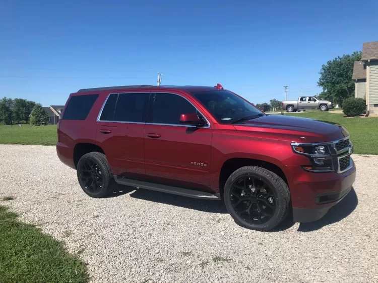

  2. Topic pretty much says it all. I'd almost rather get the factory size of 275/50/22 but these are on national backorder with no ETA. I can get the Toyos in 305/45/22 which many people have said should fit, but I figured I'd get actual confirmation. This is for the snowflake 22" factory design that tends to come on Denalis and such. Attached pic for reference only. Long story short, will these rub at full lock? Would live confirmation from someone who actually has this combination. I know it'll be close.
