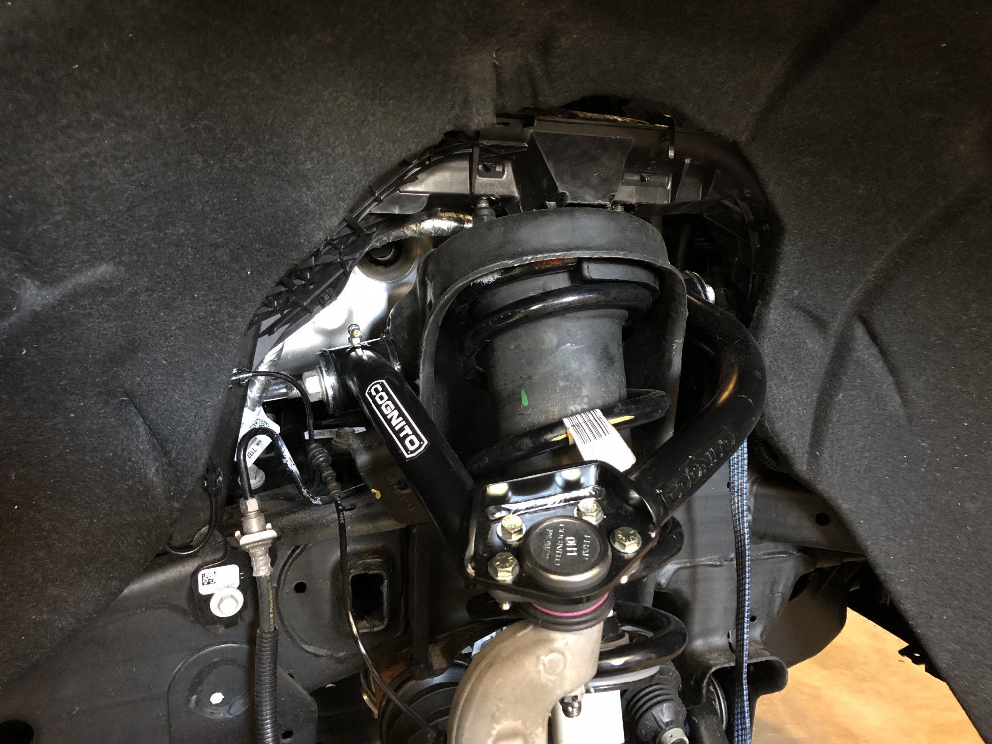

  2. I decided on and installed the Cognito tubular UCA’s. Install was very easy with no issues at all.

  4. Hi, has anyone installed these arms on their truck, I’m wondering what alignment specs you wound up aligning it to. RC and RL give alignment specs but Cognito doesn’t other than saying to set up cross caster and that a professional alignment shop will understand and be able to get it set up. Thanks
  5. Thanks Supercup, I have 0 offset wheels so clearance shouldn’t be an issue. I like both the RL and Cognito, I like that the Cognito ball joint is readily available. They gave me the MOOG part number today and I found it at a lot of places. I’d like to know where I could find the RL one. They gave me a part number but it seems to be their internal number. Plus, RL won’t sell me just the arms, I have to buy the lift kit which I don’t need. Therefore, that has me leaning in the direction of Cognito and now that Bow tie 76 said his Cognitos didn’t squeak I’m pretty much decided.
