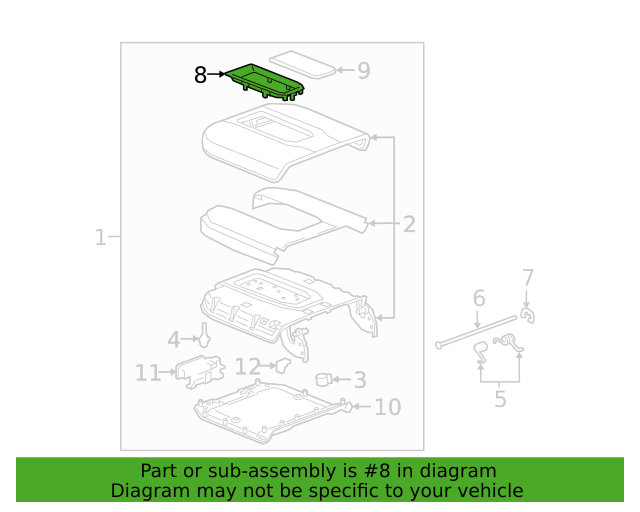

  2. I nicked the rubberized finish on my Center Console Tray Trim 84164813. I need to replace it. I have the new part but I have no idea how to separate the trim from the rest of the center console door. I tried a screw driver under the trim piece to pry it up (gently) and then forcibly. Then I was able to get my entire fingers under the side of the trim and pull up, which that didn't pop it off either. Do I just need to pull harder? Quicker? Is there a trick to the disassembly here? Any help is appreciated.

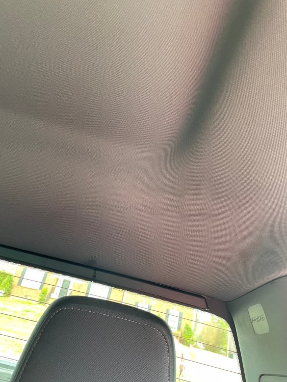

  4. The good thing is that water is no longer leaking down my rear window after the at-home service bulletin fix. The bad part is that I have a new dark line in my headliner around the same place where a small amount of water is still coming through at times. Since its only a small amount of water, I guess I'm just going to let it happen and clean the water line on the head liner every year or so, hoping the leak doesn't get any worse.

  7. I disagree. When the window frame cracks completely, the cracks extends all the way into the cab. With the headliner in place as stock, if I press upward firmly on the headliner just above the left or right headrest, I can actually see that the headliner covers the cracked frame. When the headliner is in its stock position, the water will leak through the crack and onto the headliner from behind the headliner.
  8. Well, I did do the fix. I used the Barrier Bond gap sealant I linked previously since I couldn't readily find the other sealant. I thought it was better than regular silicone. I do wish it flowed a bit better but hopefully since I just had a very small leak after 4 years, that this will fix the issue for awhile. A big SAFETY WARNING to anyone that attempts this: When you are removing the headliner, make sure to use cut proof gloves when sliding your hands around the back of the cab to pull down on the brackets. The headliner is fiberglass under the cloth and I cut several fingers pretty bad. Either take your time working your fingers in between the cab and headliner but best to where cut proof gloves. Another tip I will give is to have a hot glue gun on hand just in case the rear headliner brackets gets torn from the headliner. One of them was slightly separated on the corner and the other bracket was completely torn off. A hot glue gun put it back quickly.
