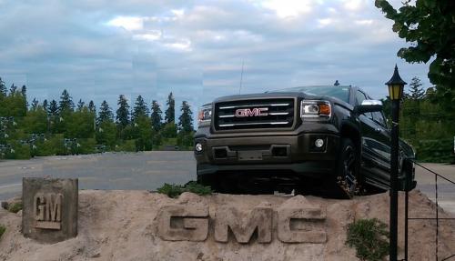

finally a nice day so my truck got a bath for picture day free photo upload -
