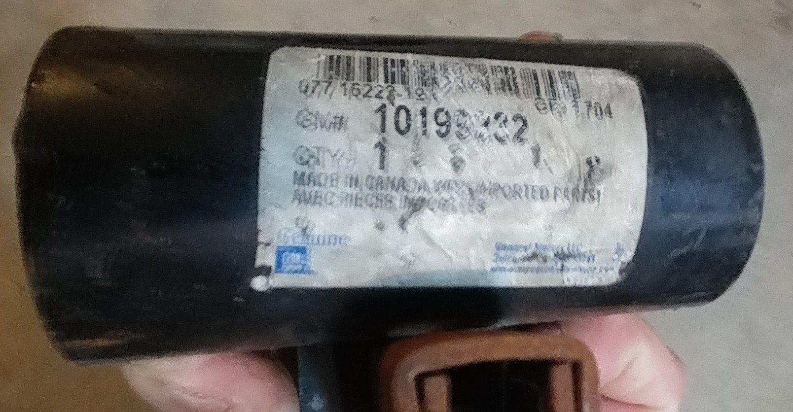

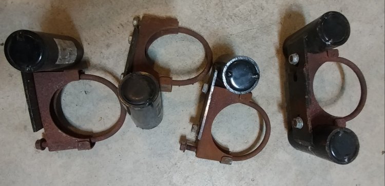

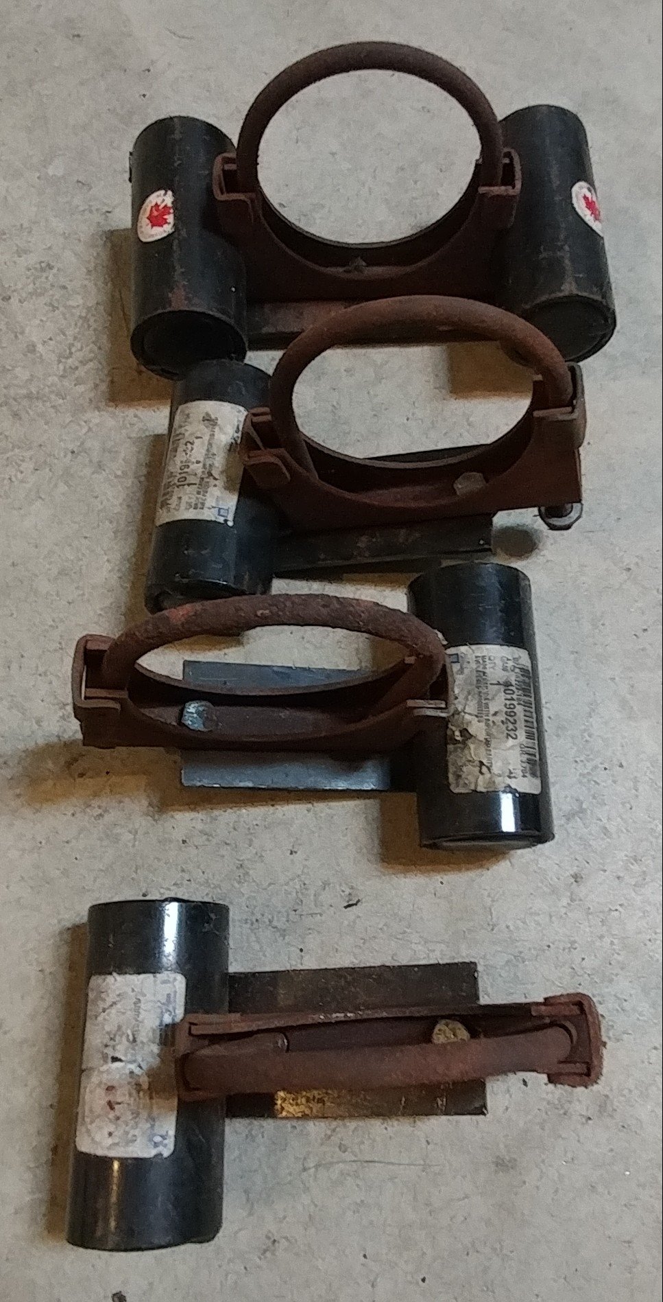

So I'm selling the dampers from my Yukon the dealer put on to lessen the booming sound. I took them off once they agreed to replace the exhaust for the newer model. GM part number 10199232, retail for $60 to $85 a piece. There's 5 (2 together for the mount at the cat). The brackets are for the 6.2L so it's 3.5" exhaust. But the mounting brackets are replaceable. Looking for $25 each, so $125 for the set. Shipping is $30. They are heavy, meant to weight down the exhaust to keep the reverberation from exhaust from entering the cab. Message me if interested. -

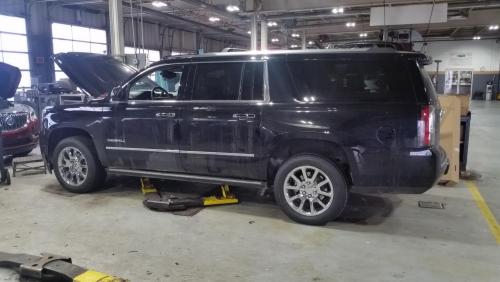

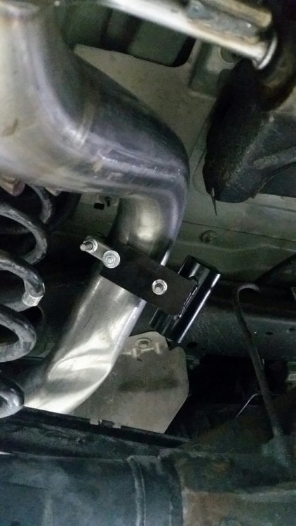

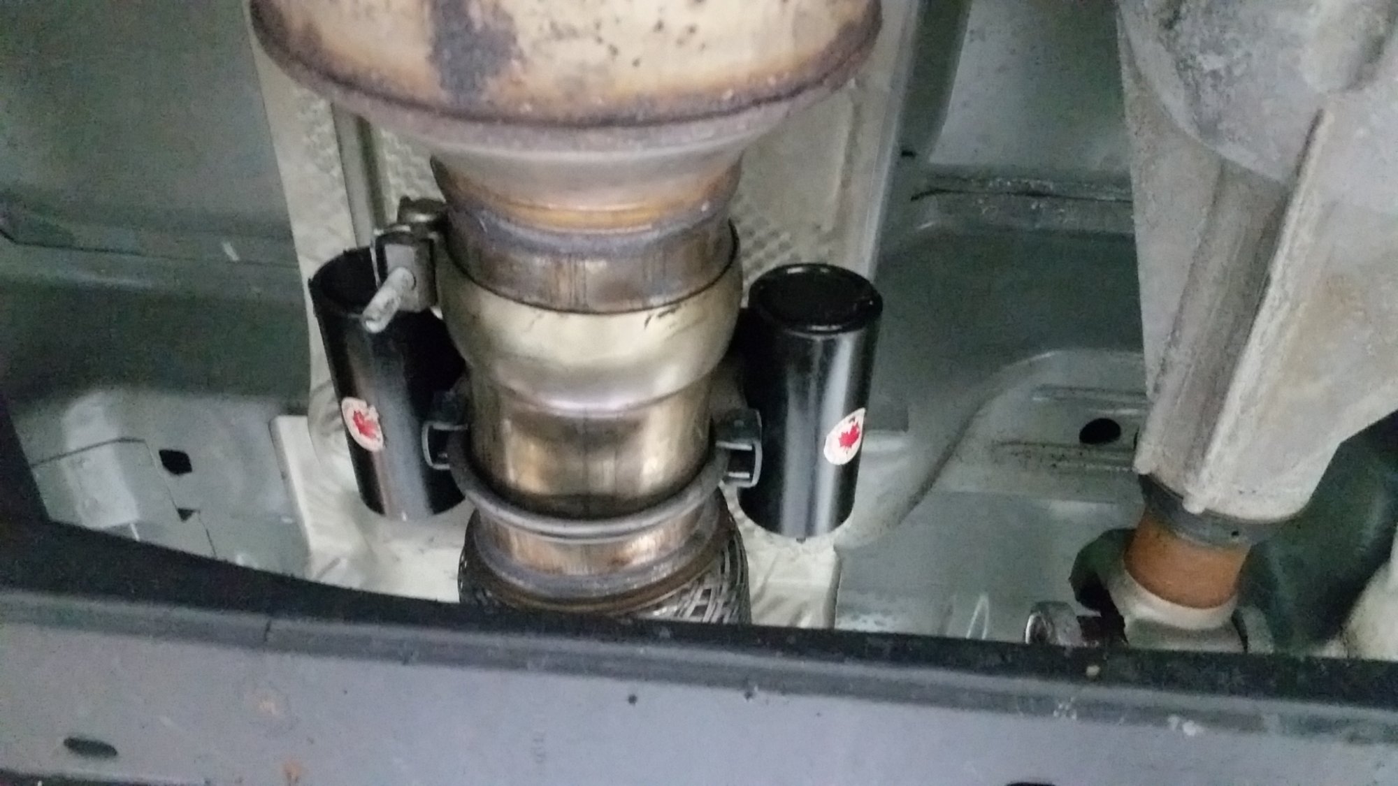

So I took the 22s off, had Michelins mounted on the 20s. The buffeting is faint at the 40 mph range, and the buffeting at the 70 range is completely gone. The truck rides like it's gliding on air. It's like you don't even know it's there now. One the drive home there were times I looked down and was shocked I was going 85/86. I had to slow down. The vibrations were my indicator before. I knew I had hit 72 when the shake would start. We ordered 5 dampers and installed 4 like other have. I realize that other that had this done had a short wheel base. So it yiu look at FogDucker's photos, his muffler is immediately after the mesh joint. So his 2nd damper is right before the muffler. On mine being an XL, I had a long stretch of pipe between the mesh joint and the miffler. We placed the second damper in the middle of that pipe. My booming is significantly reduced. But not completely gone. I'd say about 85% gone. I'd attribute this to the 6.2L XL exhaust being much longer and larger than the short base 6.2L or the 5.3L like Ozzii has. So when I return for an oil change, we'll put the 5th one on. We're just going to slide the #2 damper in the middle of the pipe to the left and put it again the muffler and put anot her damper directly after the mesh. FYI... 1) The dampers do not come with ubolts. GM has the dealer pick up basic items frim local shop or parts distributors that work for the dealership. So the part number for the ubolts Ozzii listed are specific to that dealership. 2) The dampers ubolt holes are sized for the 5.3L pipes at 2.75 inchest i believe. The 6.2L exhaust is wider at 3.5 inches. The shop foreman ordered the specific ubolts bracket assembly that fit the 3.5" piping. The Yukon is a great drive now. -
