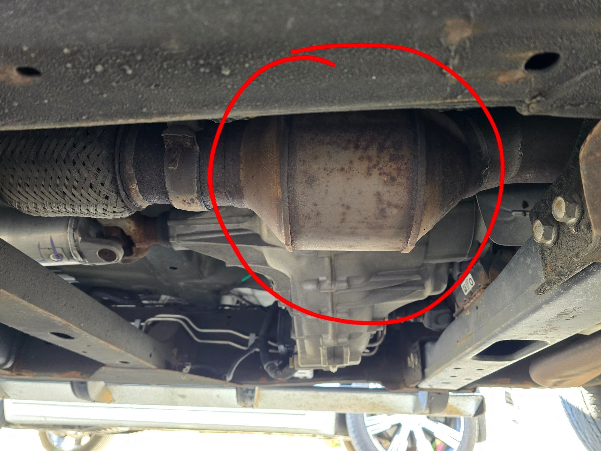

  1. So i did some tap tapping underneath the truck. When I smack the exhaust I can hear a rattling from the second cat (circled in red). So good news as it's not engine or trans, just some bad exhaust.

  4. Hey all. 2015 gmc sierra 1500 slt with 6.2 and 8 speed w/126k miles The other day i noticed this odd metallic rattling sound coming from where the engine meets the transmission, that general area. I cant say for certain that it increases with revs, hard to tell from the cab. Sometimes it's there right on startup, other times not. Here is a youtube video of it https://youtu.be/K_kR47dC5PE?si=LPfcTWPIm7XwrZlH
