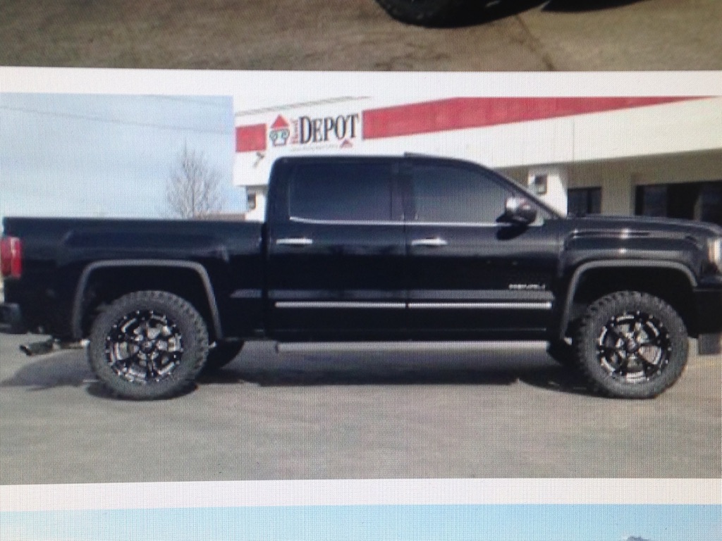

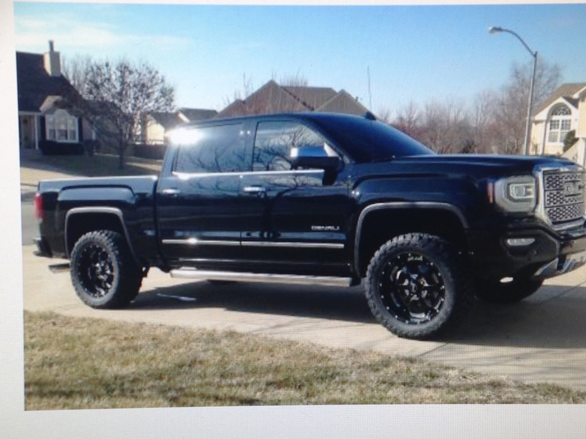

  1. Thanks for the pics! Love that look, awesome looking truck, that's exactly what i am going for! Never really thought about 305's, can't believe they don't rub, i am glad! I love it, and also like the bfg's. Thanks for the info! This is the truck that started my love of this look. It is 295-55-20 on 20 x 9 0 offset, he said he has no rub!
