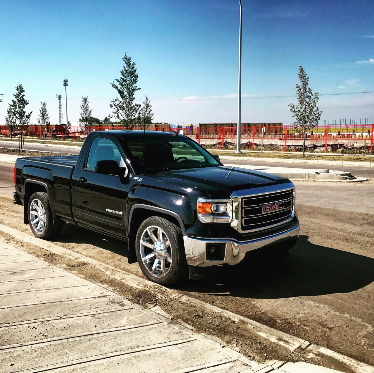

  15. Couldn't resist any longer, it needed to be lower.. Im now at 2" front 5" rear drop, sits perfect, and the belltech shocks/struts ride 1000x better then the stock racho's just in time for winter, had to put the winter wheels on this weekend

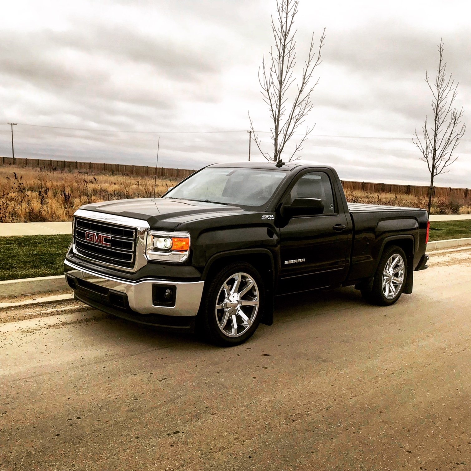

  20. I ended up putting in a set of Belltech struts in the front of my truck, so im sitting at 2" drop in the front and a little over 3" in the back with shackles and blocks removed from the back. It still sits a bit high for my liking in the back, but it sounds like to go any lower I would need to go to a flip kit, havent decided yet if i want to do that, don't really like the idea of cutting on such a new vehicle, do any kits require less cutting then others? I really only want to go down another inch or so.. And any recomendations on rear shocks for a regular cab? I hear a lot of people say everything is designed for the heavier crew cabs and ride rough on the regular cabs, the front belltech rides much better then the stock rancho's, was thinking of going with the belltech street performance 2212FF. anyway hers a pic of how it sits now

  23. Pics or it didn't happen! haha I think i have a plan of attack for my truck unless someone can tell me a better alternative I see lots of complaints about turning radius with drop spindles so my plan is Belltech 25004 2" drop shocks, and that way if i ever do want to go lower i could add spindles. the only issue i have read about with those is getting proper alignment but from what i can tell a set of Belltech 4955 bushings should get it where it needs to be. and for the back i think i am going to leave it with shackles and blocks removed for now, I have seen a few pics in this thread with guys with that setup and it looked good, then i think ill go with some Belltech 2212FF rear shocks, anything has got to be better the the stock rancho's Thoughts on going this route? anything im missing? Top pic is how it sits now, bottom is stock
