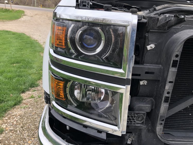

  1. Here are some night shots. mini D2S 5.0 kit with 35 watt hylux ballasts. 5500K D2S bulbs. The D2S exceeded my expectations once I was able to line them up and take a drive tonight. The 5.0 is on or with my FXRs in my old trucks. With a fraction of the modification necessary to make it work. the splitter that allows the bi-xenon high beam function in conjunction with the factory halogen high beams really enhances the brights. I did add some syllabi’s silverstar ultra 9005s while I had it all apart. Better than stock but not the same color temperature. That’s ok. The output is outstanding. i highly recommend @FastWS6TA kits.
  2. Projectors in and all put back together. you weren’t kidding about that blue coating, holy cow! install process was very easy compared to my old FXRs on my tundras. About 2.5 hrs start to finish. waiting to get night shots tonight
