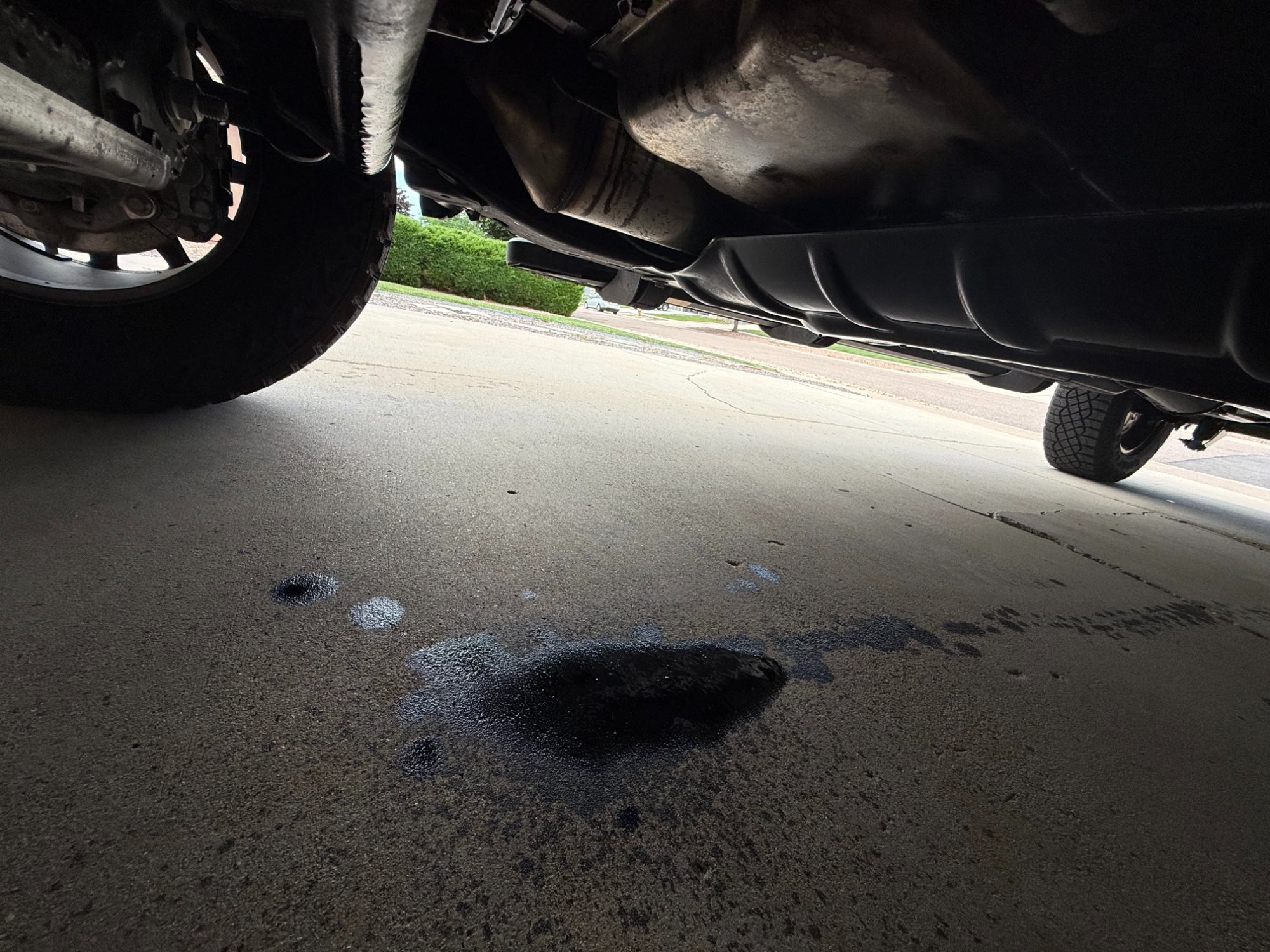

  1. All, Just wanted to see if anyone else had this issue on a newer LZ0 diesel engine... Just passed 2.5k miles and when I came home from work, I found a nice oil streak coming up my driveway. Looking under the engine/trans, I could see the inspection cover leaking a good bit of oil. I think it might be the rear main seal or cover, but the dealer is having it towed in tomorrow to take a look. Super frustrating, especially since I have to take time off work to get this taken care of.
