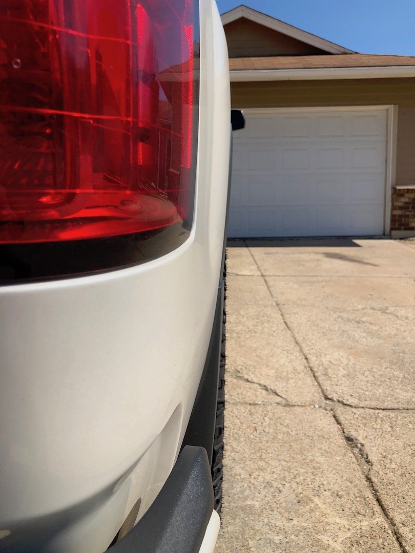

  6. I went 1.5” all the way around and you can kinda see the back wheels are out a bit farther. Sent from my iPad using Tapatalk

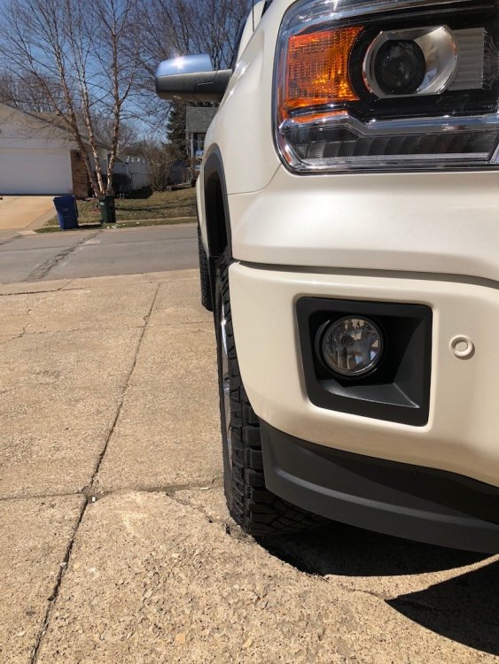

  9. I’ll get picks up when it’s light outside. I have 20” stock snowflake wheels with 33” tires and 1.5” wheel spacers!! It really set the truck off, made it looks much more aggressive. Plus the snowflakes have little pocket where it meets the spacer, so I didn’t have to cut the factory studs. I would recommend 1” spacers for the rear and 1.5” for the front. They don’t line up exactly. You will be the only one to notice so I wouldn’t worry to much

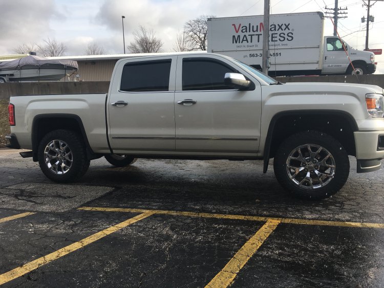

  11. Here is a side view of the truck, before the spacers. What do you guys think, do i need 1.5" spacers on there or just leave it?
  12. 2015 GMC Sierra All Terrain. 3" lift, with 275/60R20 Goodyear wrangler duratrac tires, Superchip and K and N intake. Bought 1.5" wheel spacers but debating putting them on... Thoughts??
