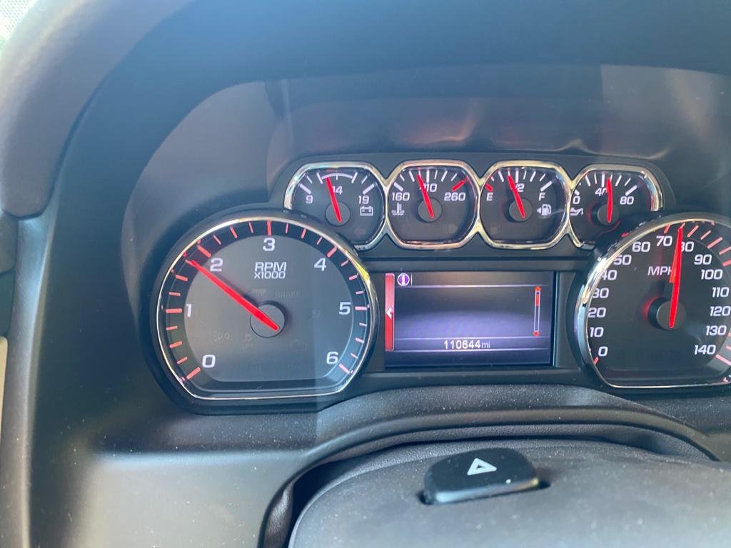

  3. So while I was driving down on a highway my dic information screen suddenly started blinking and than disappeared. Since then, it randomly disappears and appearing back. When not working I’m getting parking assist not available message (only when it should work not while driving etc) Ive also notice that the exterior temperature on the infotainment screen is not working as well. anyone else had this issue?
