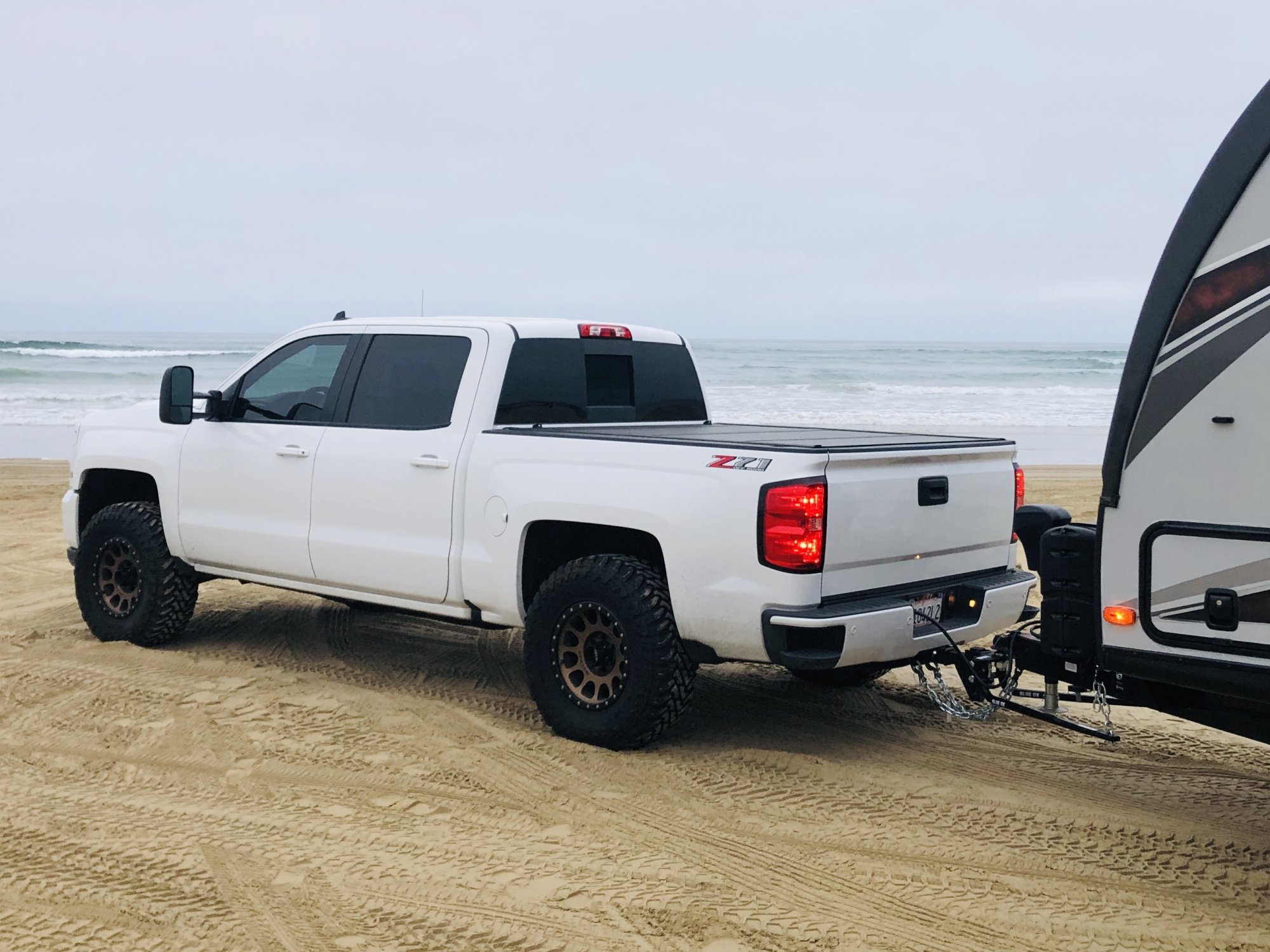

  5. For sure, don’t see too many with the bronze wheels. No just travel trailer for now.
  6. Thanks. Fox 2.5 coils and cognito uca. Tires are 295/70/17 Toyo MT on method wheels.
  7. Good looking Chevy! What side steps are those?
