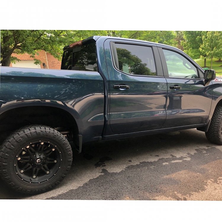

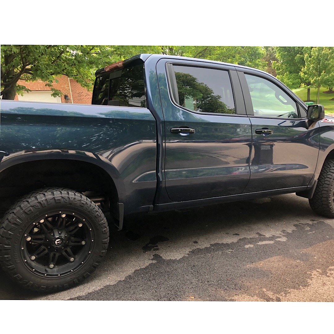

  20. Fuel D531 -12 offset, 20x10 Nitto Ridge Grapplers 305/55r20 No Spacers, No rubbing, No Trimming
  21. It’s just a scary sight lol. Maybe I’ll hold off, I don’t think I’ll like the look if they stick out more. Just glad they fit though
  22. It’s just a scary sight lol. Maybe I’ll hold off, I don’t think I’ll like the look if they stick out more. Just glad they fit though

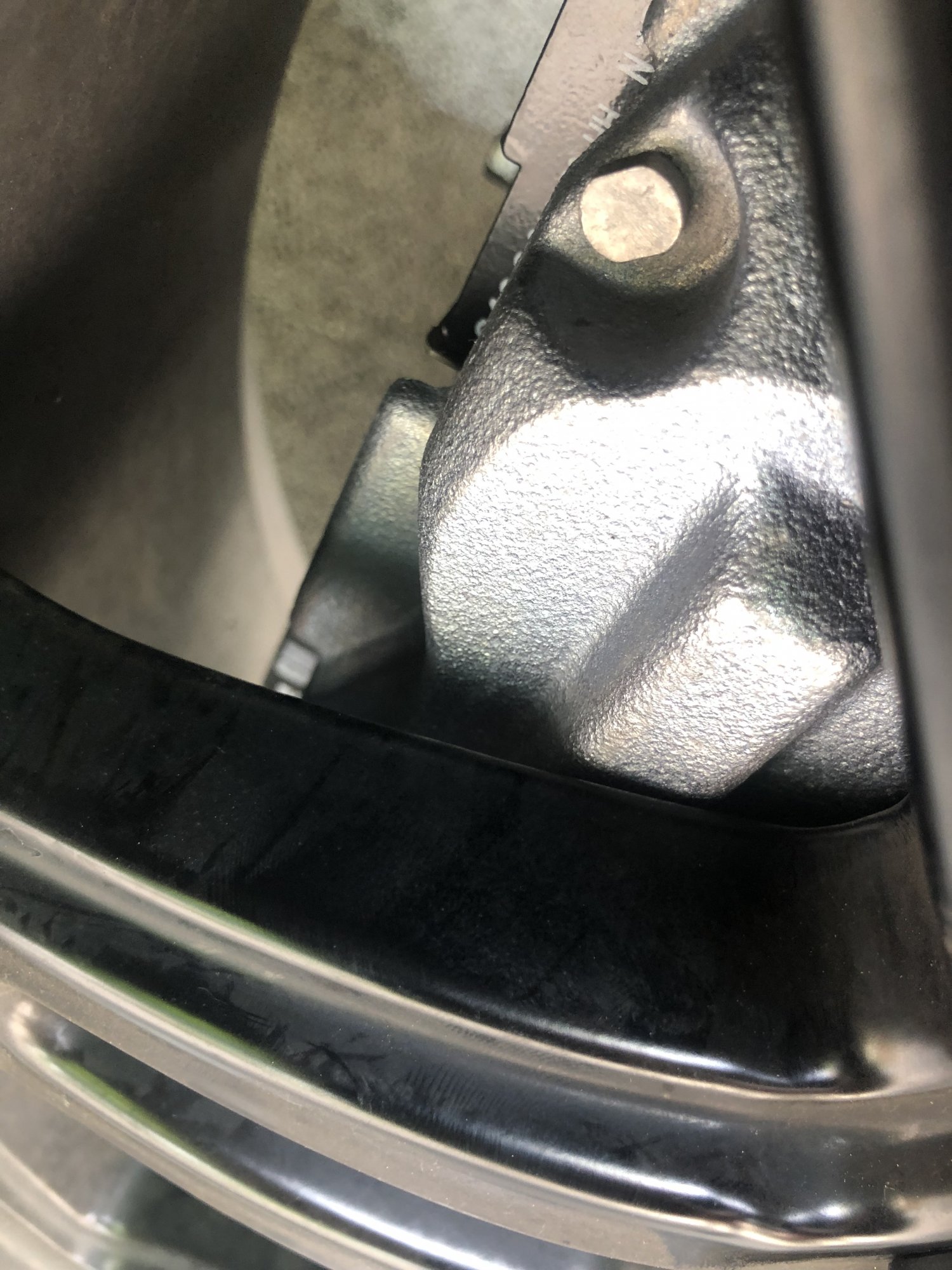

  23. Very close fit though, will be adding .25inch spacers
  24. Fuel D531, no spacers, TrailBoss stock lift 20x10, -12 offset, 305/55 ridge grapplers. Looks so much better. ....Also....no rub, no trimming
