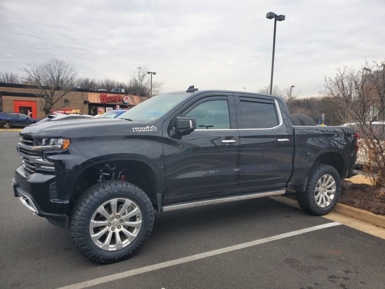

  16. I'm running 37's on the factory 22's with a 6.5" lift. Minor trimming of the inner fender well. Factory are 275/50r22 which is roughly 33". Can only imagine you can get to 35" with minor trimming, if any. I searched the gallery on customoffsets, and there are some trailbosses running 35's stating just moving a couple brackets. You should be good.

  19. I have slight rub on inner fender well, on 6.5" lift, stock offset, in reverse (or big compression while at full turn), without trimming. So can only imagine, you would definitely have to trim quite a bit...depending on your offset, might be a different location.
