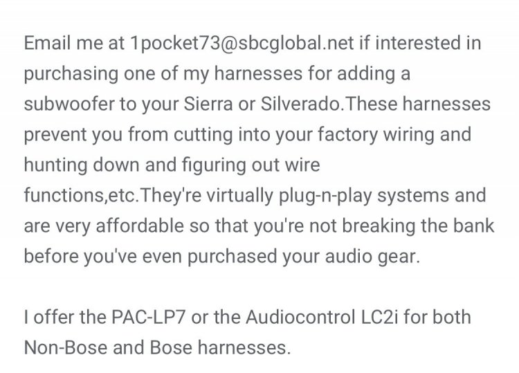

  5. It plugs in between the oem harness and the Bose amp behind the seat.
  6. Those of your that have swapped the oem Bose speakers and amplified your new door/dash speakers, how did you get that accomplished? I’m looking at adding a 4ch amp to replace the Bose setup.
  7. Contact this guy. He makes his own and was very responsive when I contacted him. I didn’t end up purchasing anything though.

  9. The truck wedge might be better if you want shorter. This sits about 4” from the door side edge pushed against the little hump and short of the seat. I really wanted it to fit under the small seat but oh well. I can easily remove the box and throw it in the back if I need the space. I couldn't imagine needing more than the T3. If you really want the whole neighborhood to hear it or rattle the interior apart sure. This thing hits hard enough for me and the only time I have it turned right up is to laugh at how ridiculous it is. You can feel it in your chest at low volumes and it moves your hair and vibrates your eyeballs if you turn it up.

  12. I paid $1200 CAD for my setup installed but they didn’t use a LC2i (something different, not as good, and I’ll be cleaning up some of the install). I’ve also been dealing with them for almost 20 years. For $450 I’d buy a quick connect Lc2i with harness (no splicing) and install the power wires myself. An amp install kit is $30-$80 depending on wire size.

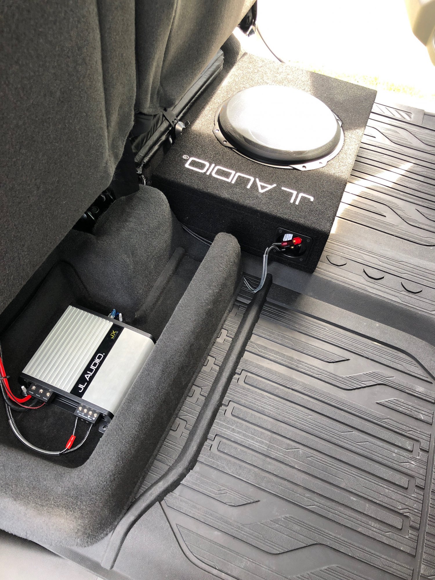

  14. I just had a JL 12” TW3 powerwedge with a JL JX5001/D amp installed last night (no pics because I need to clean the wiring up first) and boy does it sound good! Fills in the sound quite nicely, the 12” digs down to get those low frequencies, and it’s a sealed box so it’s nice and accurate, not bloaty and boomy. The box fits easily under the seat and the amp is tiny! Things have changed in 15 years since I last had a big sub/amp and I can’t believe how small the equipment is now. I haven’t had the kids in the truck yet but they love when I turn up the home stereo for them. I’ll probably put their hearing protection ear muffs on for a demo ? There’s othing like the feeling of being punched in the chest when the base hits.
