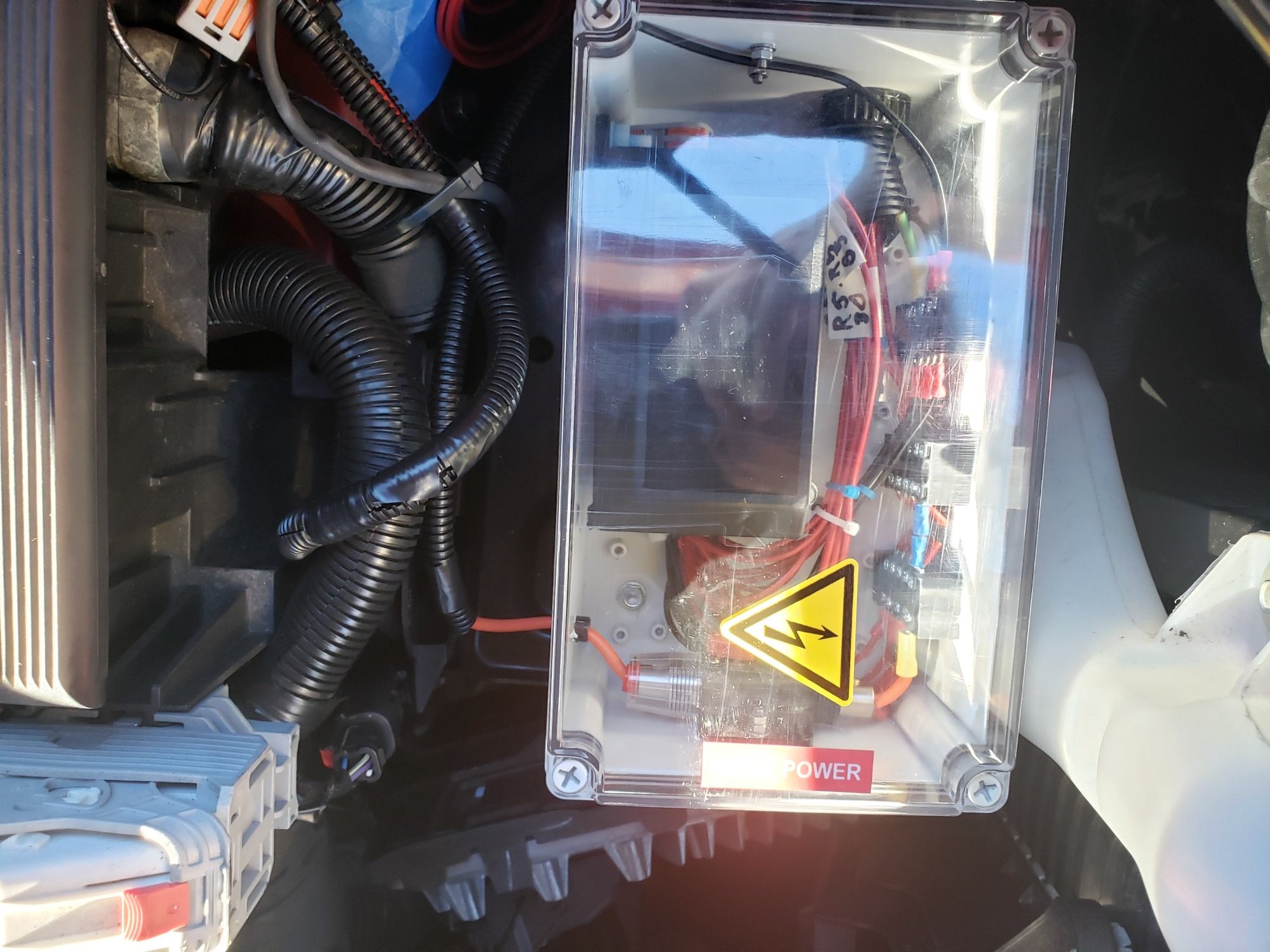

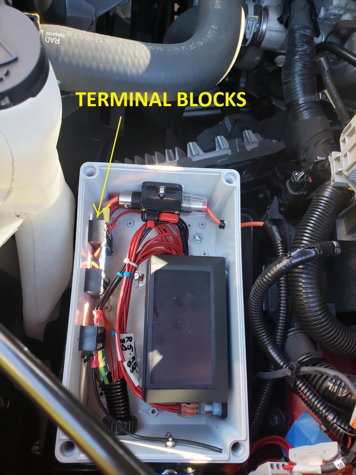

  3. When I bought my 2018 Silverado, I knew I wanted to add some extra lights (3” Rigid cube Ditch lights, Rigid Ignite aux reverse lights, bed light strips, etc). Lots of options out there for Switch Pods and Relay boards to control it all….but I wanted something more durable and serviceable. I don’t trust relay modules with small solid state relays in an environment that sees vibration and large temp swings. So I decided to build my own power distribution and relay box, which fits in the 2nd battery location under the hood. With Rocker Switches mounted in my overhead console, to trigger the relays. Is it bigger than it needed to be? Yup. Overengineered? You bet! But it’s done in such a way that I can diagnose problems pretty easily, and all wires are plugged so I can remove the system if needed, or separate into pieces to replace parts. Also allows for future expansion if I want to add bed lights, rock lights, and a disco ball. Started with a 11”W x 7”H x 5.5”D weatherproof junction box on Amazon. Has a screw-on transparent lid. Enough room inside for a 6x fuse & relay box, input circuit breaker, screw terminal blocks, and wire bundles. Instead of doing the entire write-up here…I’ll just mention the highlights. I attached my diagrams/doodles/pics/descriptions, as well as list of parts I purchased, as a PDF that can be downloaded. Questions/Comments welcome. 18 SILVERADO WIRING.pdf

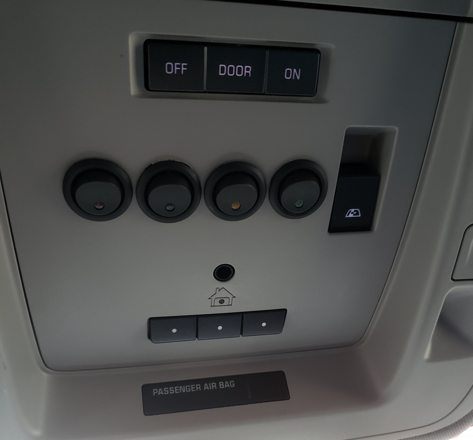

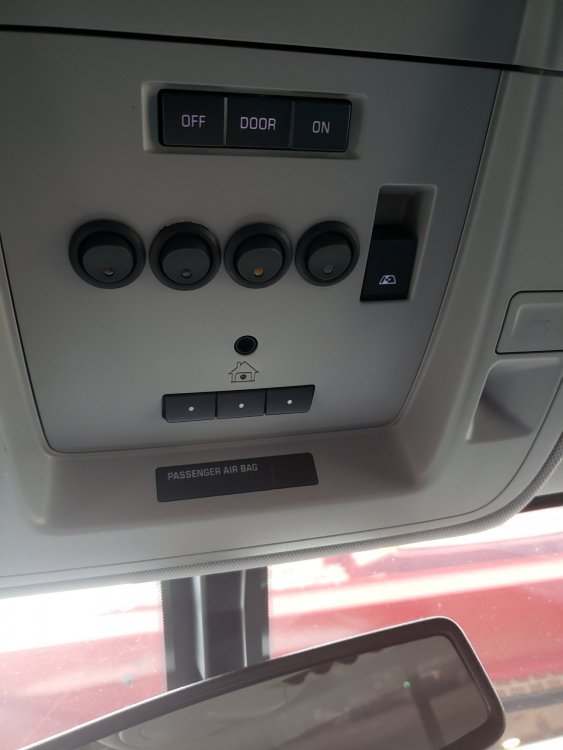

  5. Here's mine. 4x 20mm illuminated round rockers from Amazon. Used a step drill bit for the holes, and super glued into place.

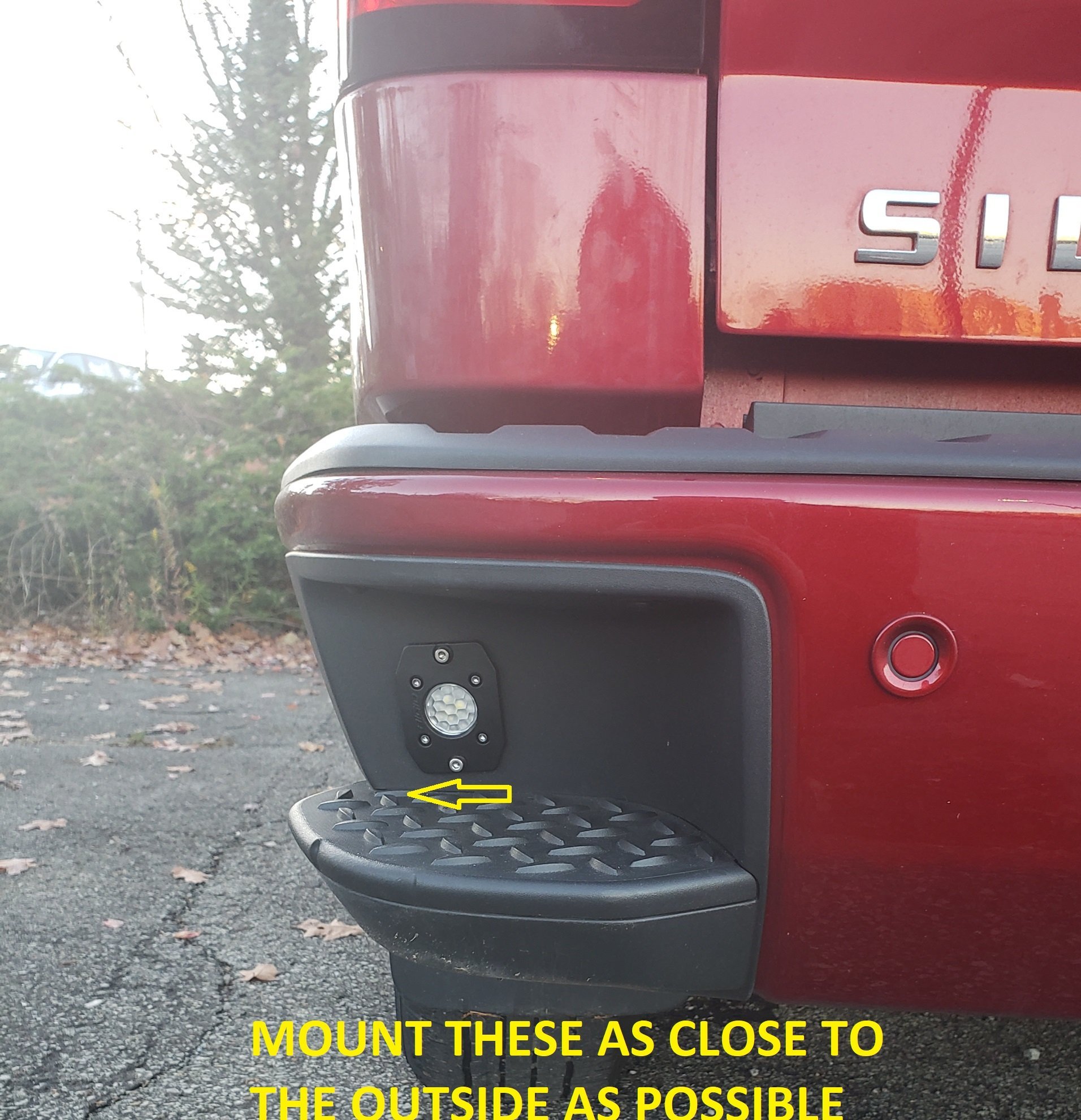

  11. I imagine he is used Rigid Ignite Flush Mount pods.....that's about the only size of Rigid LED light that will fit in there. I attached a pic of what one looks like.
