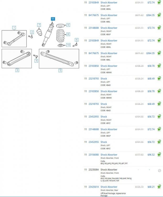

  11. Thanks for the heads up on needing the shocksims. Wasn't thinking of that. Vin for similar SLT sounded like it would narrow down the different shocks available, but when I entered the vin on gmpartsdirect.com, when it comes to the coil spring and the shock absorber there are more than 5 different models. (see screenshots). Would anyone know if there is a particular suspension model option that is best for conversion from the magneticride ? Or does it not matter, could just pick any one from this list? Thanks.
  12. Our 2015 Yukon Denali we just bought with 101k miles on it, it rides a little rough. We have driven a tahoe before and it hasn't felt this bad. After doing some research I am finding out the magnetic ride suspension goes bad pretty quickly and becomes a rough ride. I saw somewhere that some people were removing the magnetic ride suspension on denalis and replacing it with the regular suspension thats on the lower trims of yukons and tahoes. Has anyone here done this? If so any issues caused by doing this? Also if anyone has done this, I would be interested in finding out exactly what parts are the best to swap to the regular suspension (part numbers etc.), as there are many different part numbers for the same shocks on gm's parts website, wouldn't know exactly what to start with when it comes to converting the magnetic ride back to standard. Thanks.
