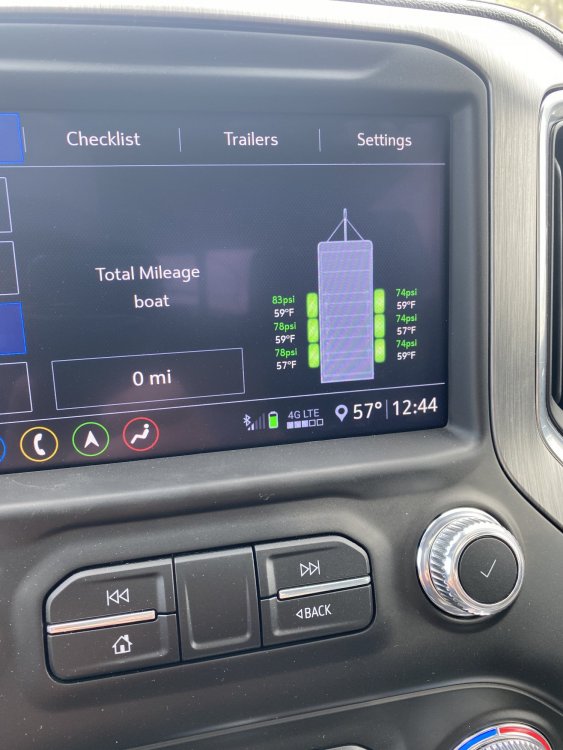

I ordered mine off eBay and they sat in my glove box for weeks. Had them installed today. When I hooked the truck up and setup the trailer profile it prompted me to program tpms. Said I could do it manually or with tpms tool. I decided to try manually. Pressed start and went in order letting air out of each tire for at least 10 sec. got back in the cab and it was done.
