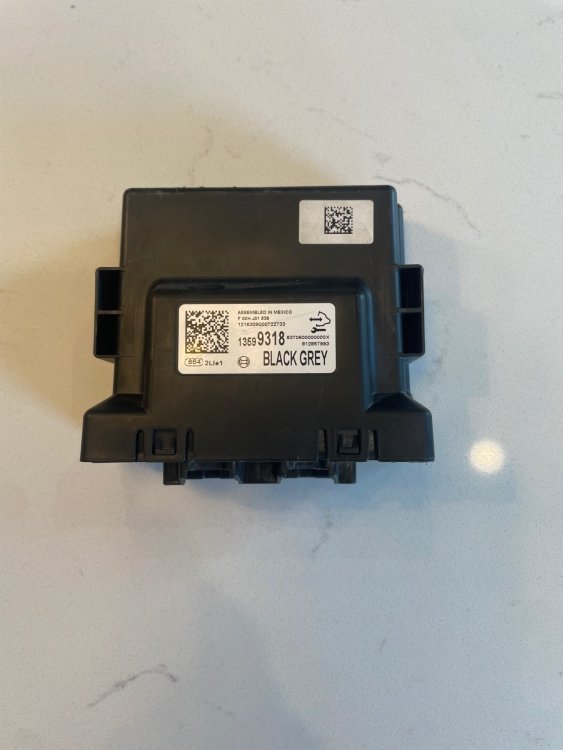

  3. Update: I found a couple more grounds to check and clean, but the issue is still happening. These are the codes that come up, and the BCM is the main thing I'm looking at. Is there a way to know for sure before getting another and having it programmed?

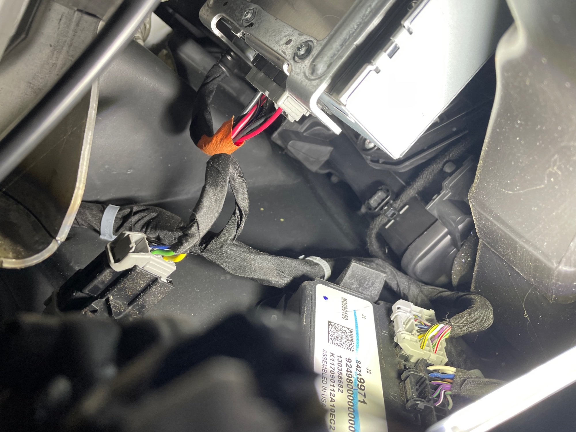

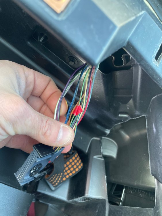

  6. What's a good reader? I've been able to go by AutoZone right when this is happening, but it doesn't throw any codes. I was wondering if there's a tool that can analyze the whole electrical system, but haven't heard of any. Something I found today, is there are several things that have been messed with on the wiring. The Serial Data Gateway Module has been removed before and one of the wires going into the harness for it have been spliced. A couple other harness in the same area have electrical tape on them, and there was a wire coming from the plug in the back of the cluster that had a piece of tape marking a wire. This truck looked new when I bought it with 10k miles, but had a lift and nice tires. I had wondered why someone would trade it in right away, but maybe there were electrical issues right when they bought it? I'll include a couple pictures of what I found today. All I can think right now, is to try and find diagrams for what each wire is, but I wish they weren't so hard to read. Edit: this site doesn't like me trying to add several pictures for some reason.

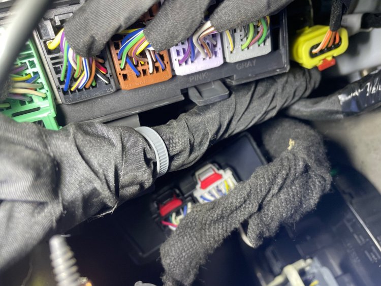

  9. Also, I'm not sure what these are for, but one of those red clips was popped down in the position to disconnect it. I wonder if that, or something else is loose, and when it heats up outside they separate a little. That's the only thing I can think of since it only happens when it's hot
  10. I found the connector, but can't tell if anything's wrong. Here's what I'm wondering, I got a stereo system hooked up when I first got my truck. I'm not sure exactly how they ran the wires, but it looks like they went into this under my dash, because there's electrical tape on it. Is it possible that isn't getting a good connection when it heats up outside and messes with it? The radio doesn't ever cut out though
