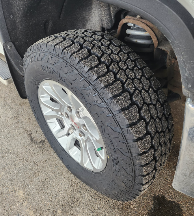

I just installed new Sumitomo AT tires a few weeks ago. Did a 500 mile roadtrip, pretty pleased with the quiet smooth ride. If you're looking for an AT tire, these are tied with BFG KO and Toyo AT3 for best in category on Tire Rack. They're significantly cheaper. I got my 265/70/18s for $171 each, plus shipping, from Discount Tire Zone. All-in price was $768 delivered. https://www.tirerack.com/tires/sumitomo-encounter-at It's a Japanese company that also includes Dunlop & Falken. My tires were manufactured in Thailand.

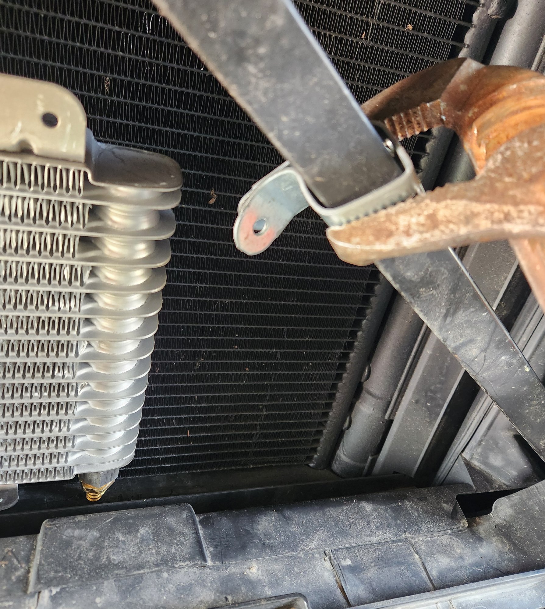

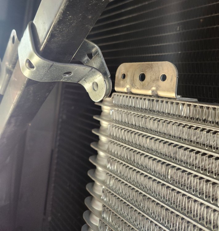

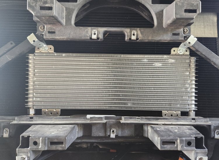

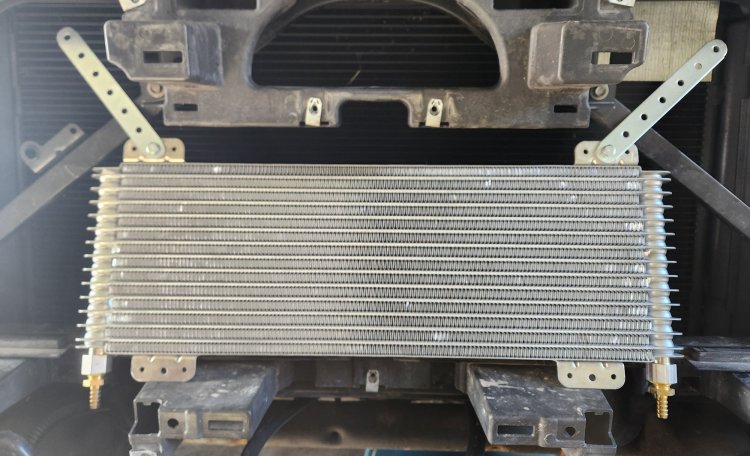

A few months ago, I had a failed lifter with bent pushrod, ended up doing a large upgrade with AFM delete, stage 2 cam, and upgraded Circle D torque converter. Then I had it tuned. The higher stall speed of the new TC was increasing my transmission temps during prolonged hill climbs, such as heading up the ski hill. I decided to add a Tru-Cool 40k which I ordered the genuine part from Oregon Performance. I already have a Derale remote transmission filter, so I bought a sandwich adapter from Derale and put the two together, with new 3/8 hose running to & from the Tru-Cool cooler. I mounted it in front of the radiator as most do, and used the provided metal straps to bend and design my own make-shift clamps. Just took a lot of dicking around with some plyers to get something that would hold it in place. The 3/8 hose runs straight down through 2 small gaps in the plastic trim and connects to my remote filter setup. I'm very happy with the results, it decreased my temps approximately 70F while going up the same ski hill ( 220F before to 150F after)
