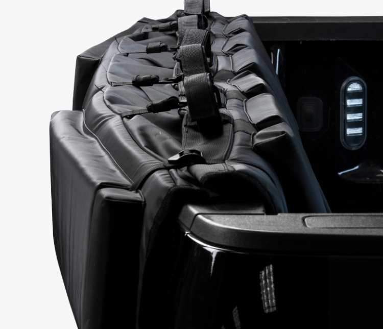

I finally got the RaceFace T2 pad. Fits pretty good, lots of adjustment in the straps for the varying thickness of the top of tailgate. I need to adjust the opening on the pad for the backup camera some more because the pad eats into some of the left side of my view. On the tailgate latch itself, the camera appears to be on the left side of the latch but I don't know what the other camera-looking thing is on the right side of the latch - does anyone know? I'm new to backup cams. -

@Justin Vaughn I was really hoping to get a RaceFace T2 pad because they seem to have way more padding than other brands but I can't confirm that it will fit properly with the backup camera - since the camera and latch on the new Silverados/Sierras are located at the very top of the tailgate. But it looks like the Thule works fine with the backup camera so I think I'm going to go the same route as you - as I plan on leaving the pad on almost all of the time. Thanks. -
