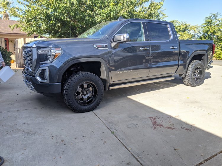

1qwktrk's Achievements
  1. they only make 4' and 6" for denali with ARC
  2. auto/AWD was designed to be run full time if wanted, but I am thinking front half shafts arent at a happy angle bds only sold a 6" kit and thats too much. It does not, only 2.5" leveling spacer over the strut and a .5" spring preload spacer. does someone make a 1-2" diff drop kit?
