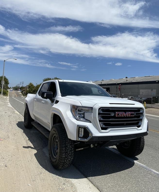

  11. Whatup guys, thought I'd share my work in progress and ask for some advice: -2019 Sierra 1500 AT4 6.2l- Bds 4" lift Fox 2.5 DSC front - Fox 2.0 rear ADD Stealth Fighter Fr. Bumper Baja Designs ONX6ARC Borla ATAK Exhaust Method MR701 17X9 BFG Ko2 315/70-r17 Pretty happy with the front suspension but the rear really needs some help. Too much bouncing and bucking in washboard chatter and whoops. Planning on adding a Fox 2.5 DSC and a Deaver Spring pack to eliminate the rear 4" blocks. Hoping to take away some harshness and add some travel. Any advice is appreciated, I want to do this right. Thanks!
