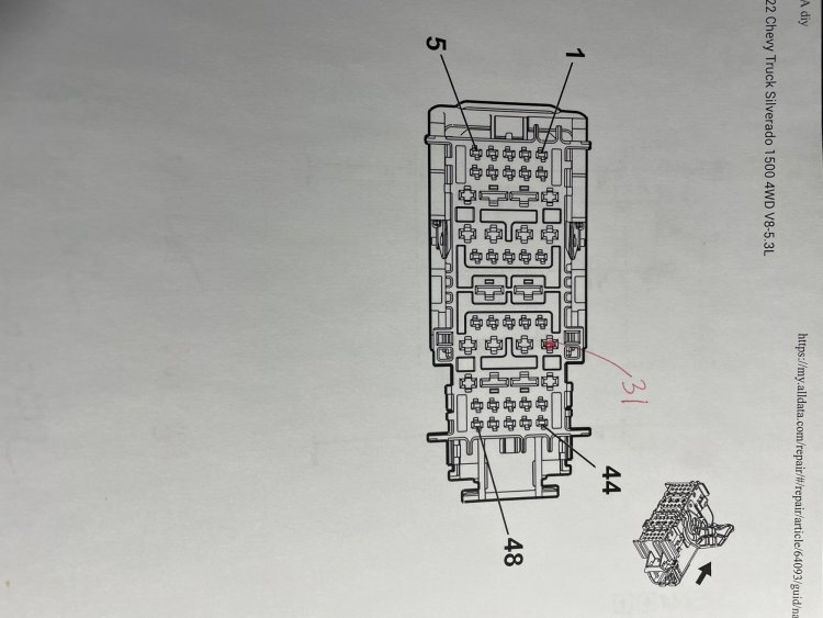

Hardwiring Radar Detector
Mike Duhaime replied to NNY1500's topic in Troubleshooting, Warranty & Recalls
Buy a 12 volt socket, leave it hang out near glove compartment or keep it inside fuse area. Pin 31 positive, get a good ground -
