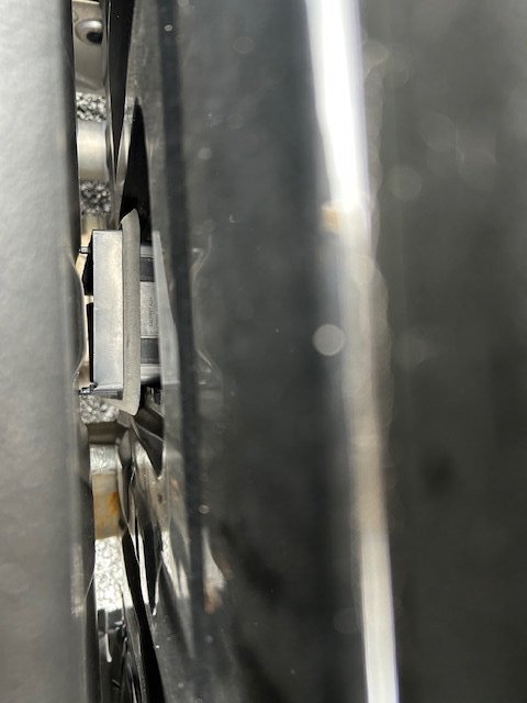

  1. I've had both issues since day one!! Saw the vents popped out when installing the tonneau cover. So upset as I brought this in many times for these issues. Just spent all morning cleaning up water and re installing these pricks with marine glue. So pissed! These vents go in from outside only, and require box to be moved back. But you can pull them back in from the inside and glue in place, add screws. It's a bit tricky to remove seat back, so check out youtube

  3. Check for a popped out vent, under back window between box. Cant get it back in. Box needs removal to access just fixed it from inside remove back seat rest. Pull the vent back in easily I added marine glue and a screw to secure them. dried out seat back and carpet
  4. Yes, but it's the vent that popped out!! Look at bottom of rear window, between box and below rear window. Chances are, a vent popped out! Replacing this is not easy, as the box must be unbolted and pulled back far enough to insert this @#$% thing. Thanks GM, for another useless feature that costs us time and money. Water pouring in FFS
