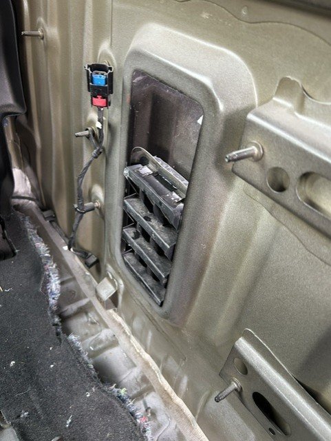

I've had both issues since day one!! Saw the vents popped out when installing the tonneau cover. So upset as I brought this in many times for these issues. Just spent all morning cleaning up water and re installing these pricks with marine glue. So pissed! These vents go in from outside only, and require box to be moved back. But you can pull them back in from the inside and glue in place, add screws. It's a bit tricky to remove seat back, so check out youtube
