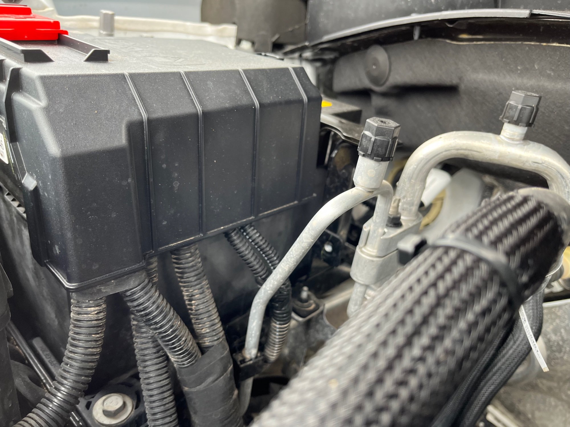

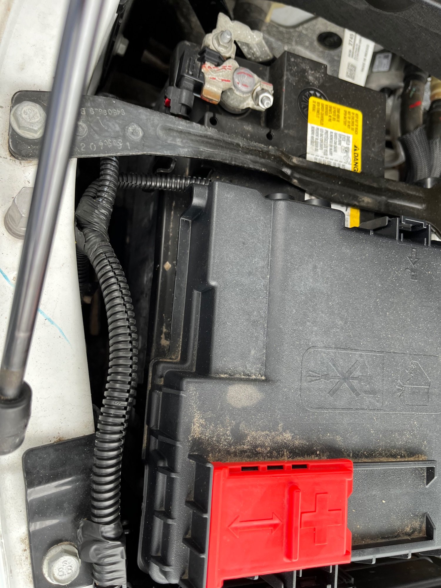

  15. What is this? Does every GM truck have this? On mine it’s very sloppily applied and looks terrible. Think I’m gonna just rip it off.
  16. Call me crazy, but I prefer halogen bulbs. If your halogen tail light burns out it’s less than $10 to fix. If your LED tail light somehow goes out you’re replacing the whole taillight. LEDs fail less than halogen but they still sometimes fail.

  20. My money is on the battery. I was hoping someone would be able to recognize my battery as being factory or not factory. When I have time I’m going to take it to autozone and have the battery tested. Edit: pulled the top cover off. Factory battery. Now I have a check engine light after disconnecting the battery lol.
