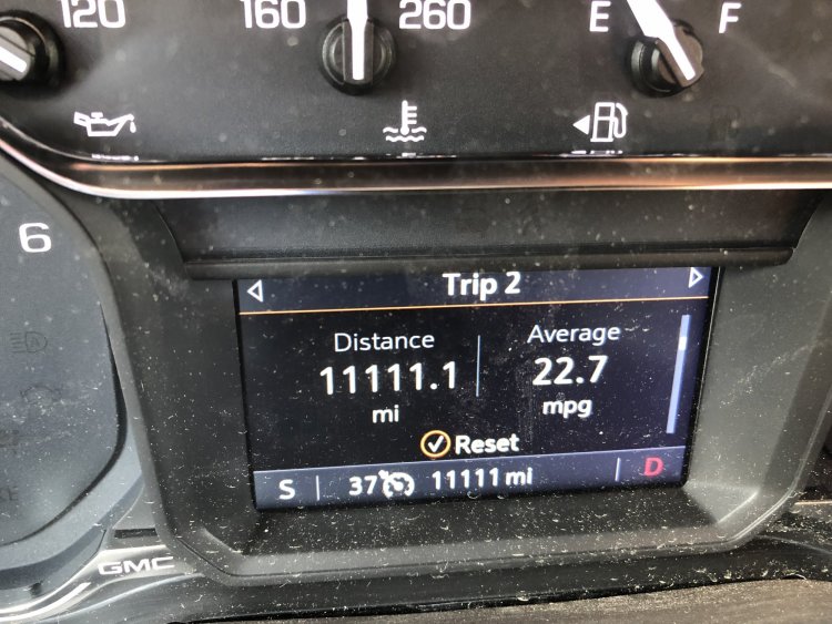

  2. My latest 2.7T fuel economy numbers..... 400 mile AVG 29.1 mpg life of vehicle (11111.1 miles) 22.7 mpg
