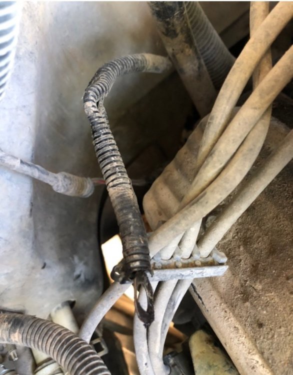

  14. Well found my other engine problem. Huge exhaust leak was obvious but still threw p0102 etc MAF codes. started cleaning my grounds along the harness then followed one strand to rear engine block and this ground was disconnected. Cleaned off the engine block bolt and reconnected, runs pretty good and no codes so far! glad I replaced the exhaust anyway because I noticed heat was starting to mess with the wiring harnesses Now on to the wheels, pretty much everything is going to have to go and dreading getting the control arm bushings replaced. On my gmt800 I just bought new control arms but Im trying to save money on this one.
  15. Took off the exhaust donut gaskets because they were toast. Huge leak coming from there. Broke off one of the manifold bolts, no biggie. Took both manifolds off to replace the studs and both manifolds had cracks in the center. Not the end of the world, they looked roasted anyway. Got the replacements in and hopefully gets the engine somewhat back to normal!
