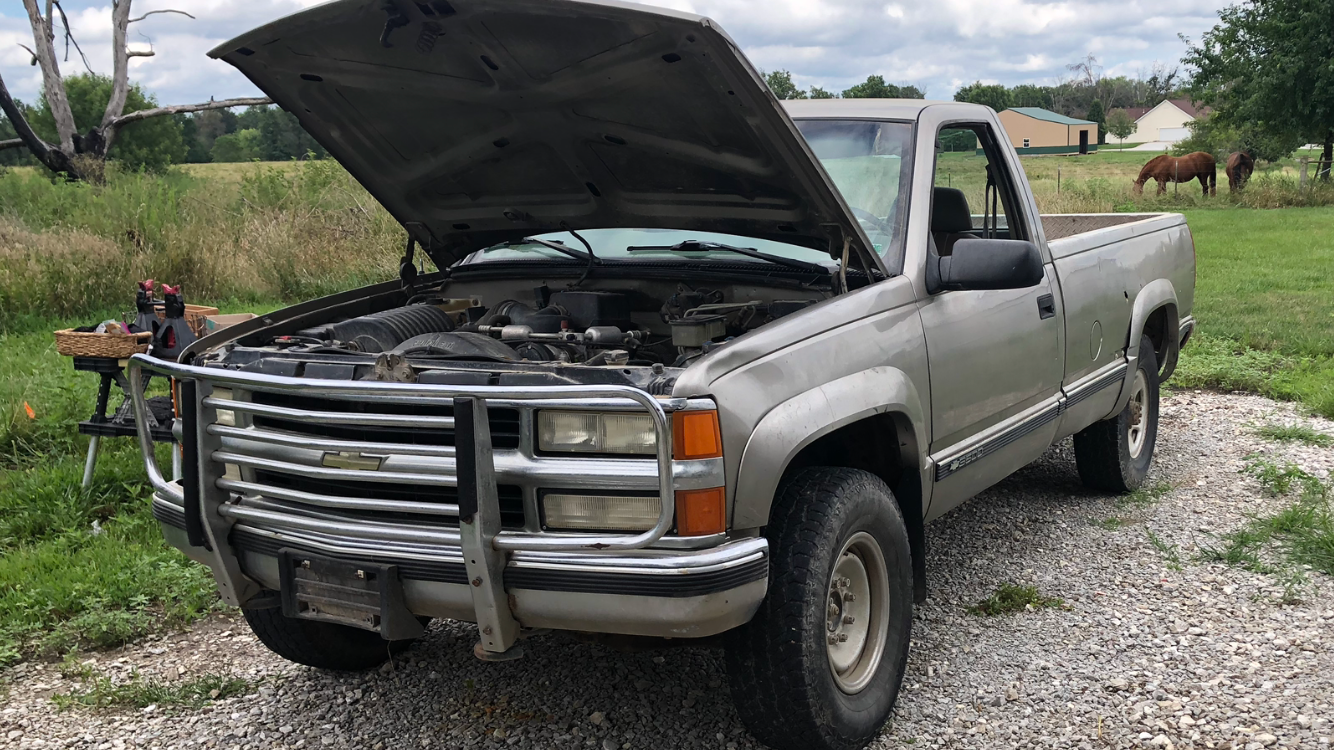

2000 k3500 5.7 4l80e So Im going to start doing some maintenance on the auction chevy I got a few weeks ago. It started on the lot and was driveable but it was really loud / rumbly and lacked power. Transmission felt fine. Ran OBD2 and found the following codes: P0102 - MAF low input P0171 - system lean p1351 - Generic dealer code The battery was crap and died after a week, it is now at 6v. I have a spare that can hold 12v for a bit so will use that. The battery cables are terrible and need replaced, frayed at ends, connections terrible. I then looked at the fusebox and the ENG fuse was blown. Not 100% sure but I think this fuse handles "MAF sensor, O2 sensors, crank sensor and Evap system valves it also connects to PCM." this blown fuse seems like it would be a cause of my engine issues and the cause of the blown fuse is probably grounding/shorting from bad wiring heres my question, should it even be possible to run and drive the truck with a blown ENG fuse??

Just bought a k3500 2000 reg cab 4x4 at auction. Gambled for a 454 but got the 350 . Engine is..."lean".. but transmission feels freaking amazing. Hobbled it home with really bad front wheel bearings but otherwise looks very clean. Happy to get back into working on these! Did these forums change? It seems way more sloppy and slow on my phone and hard to navigate through the ads. I used to frequent the gmt800 side a long time ago but sold my 2002 1500.
