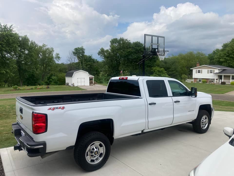

  5. Hey all. Been a long while since I've posted in here. I just bought a 2017 Chevy Silverado 2500HD WT 4x4 with the 6.0L engine. Crew cab longbed. It has this annoying (but not super loud) whistling noise that starts between 15-20mph and remains constant at all speeds above. It doesn't ever seem to change in pitch or volume and seems to be coming from the front end...but I'm not sure. I cannot duplicate the sound while standing still. Revving the motor in "Park" makes no whistling noise. The noise only occurs while in forward motion above 15mph. It was recently in the shop for a tranny fluid change and I asked them to diagnose it. They came up empty and everything in and around the area of the front wheels checked out. Here are some details. Gaining speed (past 15-20mph) once whistling has started...has no effect on it Braking...has no effect on it Turning corners...has no effect on it Switching in and out of 4H (4WD)...has no effect on it Putting the transmission in neutral while driving...has no effect on it Letting my foot off the gas...has no effect on it Pressing the gas to accelerate...has no effect on it Please let me know what I should be looking for here. I originally thought maybe it was a wheel bearing but after the shop found nothing (and considering the bullet points above) I'm thinking some kind of wind noise?
