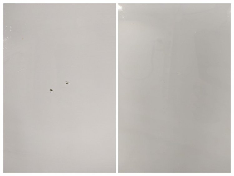

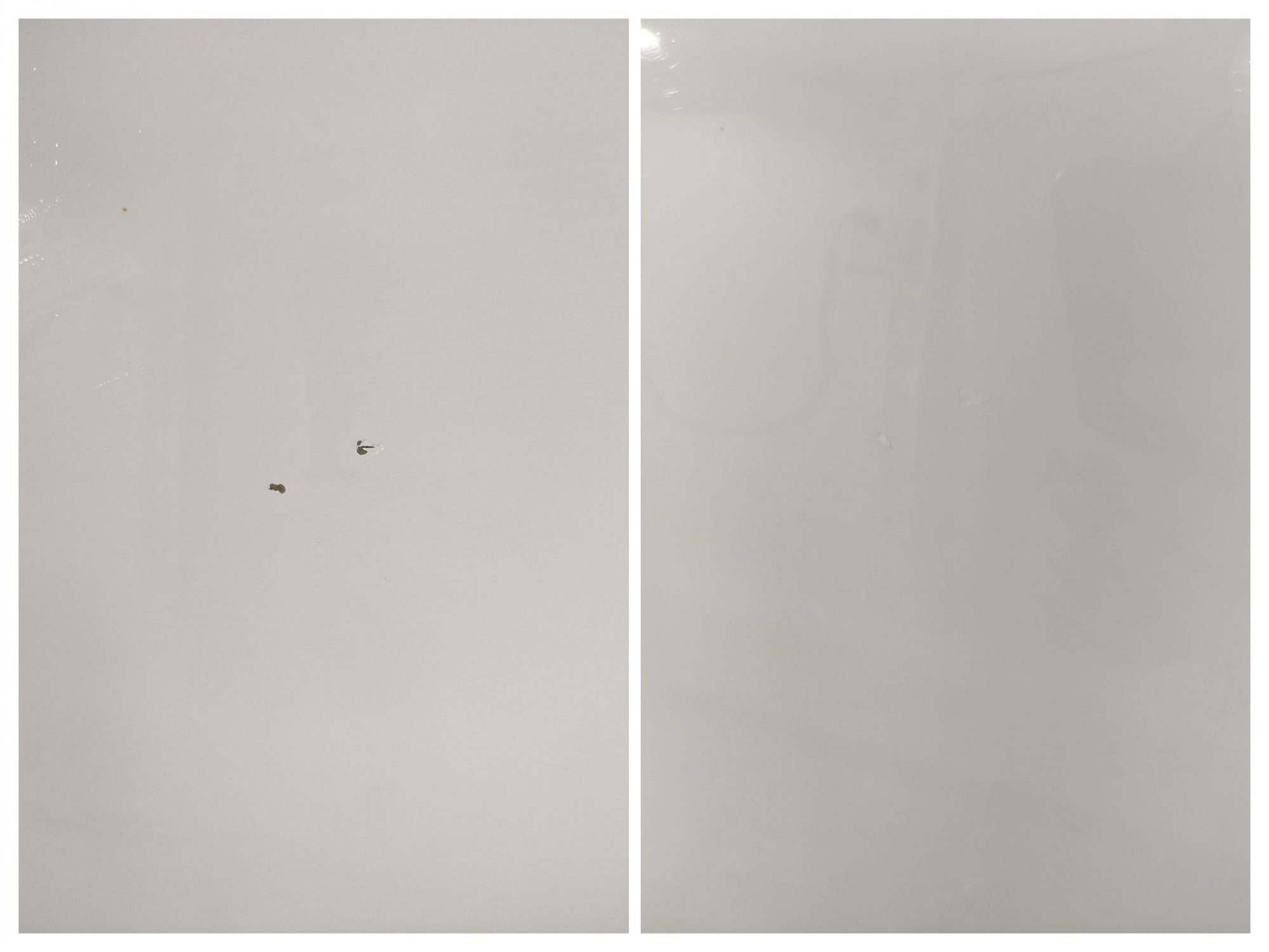

Got the paint touched up. used dr color chip and overall I'm satisfied. Paint wasn't 100% match (had the same issue paint-matching my leer topper - maybe the paint on the truck is a bit off?). I also could not get the paint to be flush. The issue I had was that all of my chips are on vertical panels and the paint just bled out of the hole before it had a chance to set. Was like pouring milk onto the white paint at some points. I tried about a dozen times over the course of a couple of days, using a combination of applying a second coat per instructions vs completely removing and starting over (including proper prep in -between). I also used the dropper, glove method, brushes, and squeegee tools. The front fender (next to headlight) seemed to finish the best compared to the doors. To be fair, it's not THAT noticeable. I fully expected NOT to have a 100% match with color or sheen, but the remaining divots drive me nuts. Ultimately, I was able to cover the bare metal and create a finish that only I'll probably notice. I also expect this to achieve corrosion resistance (which was my primary goal). It was also nearly $1400 cheaper than taking it in to a shop. So, dr color chip was a win for me, given the cost and effort. I attached an image that shows a couple of the repairs (fender + lower-door mark & door upper-door mark). The fender, especially, looks MUCH better in the photo than in person. -

2017 Silverado with 6.2 engine. Truck has 46xxx miles and just got back from having both banks of AFM lifters replaced along with fixing a bent push rod and broken cylinder valve spring - all covered under warranty. Just noticed some paint chips on the front fender and both front doors (must have gone though some construction work). Chips are small but down to the bare metal. I'm in Minnesota so I'm mainly concerned about rust when the snow and salt start flying. After getting several quotes, best I'm looking at to have the paint fixed by a body shop is ~$400-500 per panel (about ~$1500 total). $1500 to protect against rust and new tires probably due in the spring, I'm at a point where I'm beginning to question putting money into an engine with 46000 miles that has already had major engine work done. Before the paint, I figured I'd just ride it out to just before the powertrain warranty is out and see how it's been going to determine whether I wanted to hold onto. Any tips for rust-proofing the scratches and chips in a way that bridges the gap between $15 paint pen that looks like I applied white out vs full-on body work for 1.5 grand? Thoughts, guidance, or recommendations appreciated.
