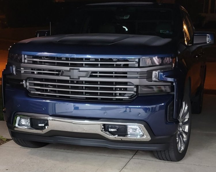

Headlights also have a slight tint applied. I was going to blackout the lower chrome area, but will likely be doing a hidden winch bumper which replaces that piece. -

The grill comes off pretty easy and the center chrome detaches. I took mine apart, planning to spray w/ removable coating, but ended up sanding and spraying with a black chrome paint. Looks good, but should have prepped better, it has chipped some. The gold bowtie also separates from grill, making painting it very easy. I've done some pieces in vinyl wrap. That works well too. Buying nicer wrap is well worth the money, it is more workable and forgiving. Vinyl wrapping is an art to get it right, imo. Im still learning. -
