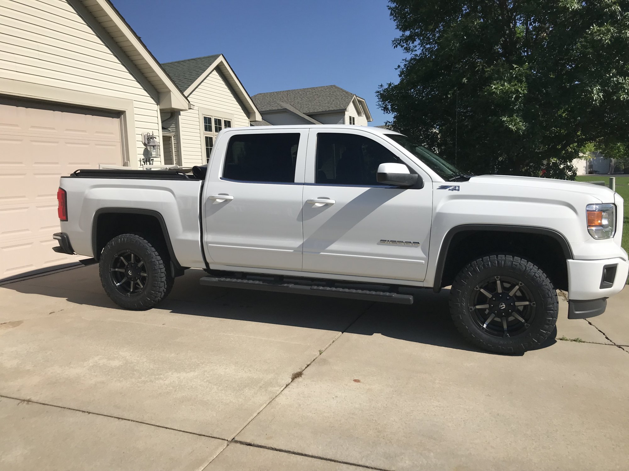

  1. Bought her brand new, but she needed new tires this year so I decided to give her an upgrade. 2014 Z71 leveled with an RC 2.5" kit. Currently sitting on 18x9 +1 Fuel Couplers (black machined w/dark tint) wrapped in 285/65/18 Nitto Ridge Grapplers. Absolutely no rubbing, and I am in love with how the wheel/tire set up turned out.
  2. What size tires and what brand/model did you go with? Also, any rubbing or cutting involved? I am looking at getting these exact wheels on my 2014 crew cab and want to avoid rubbing or cutting.

  5. Do these mount to frame or rocker? And what is the difference? I've been told to get frame mounted running boards by a few people
  6. Are these Fuel Offroad Maverick wheels? I love the look, thinking about picking up a set for my Sierra
  7. You make me regret getting my Sierra in white and not black.. Love the setup you have!
