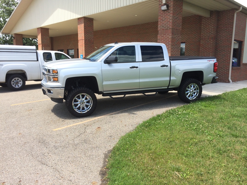

  7. This is after my 6" install with 33" trail grapplers. I have now switched to 35" toyo's Sent from my iPhone using Tapatalk
