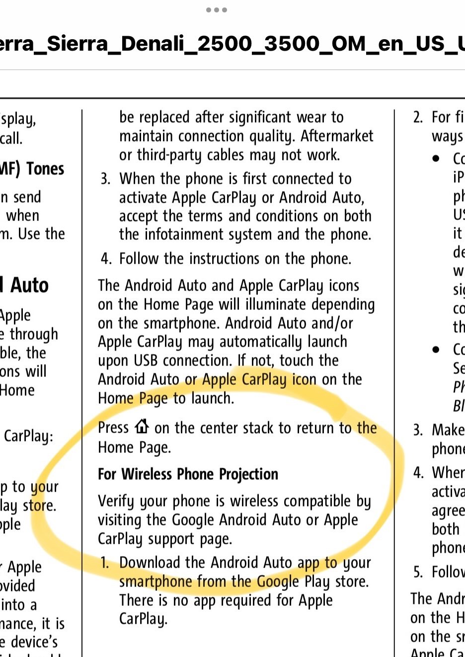

I didn’t spend a whole lot of time searching in my electronic owners manual but I found wireless CarPlay referred to a few times.
Maybe the GMC’s are different than the Chevy’s with respect to the Infotainment System.
My 2022 does.
“Wireless CarPlay works fine most startups, then just won’t on others” I have this happen occasionally on my 2022. I haven’t kept track but maybe once every 100 startups so I haven’t considered it a terrible nuisance although it can be irritating.
