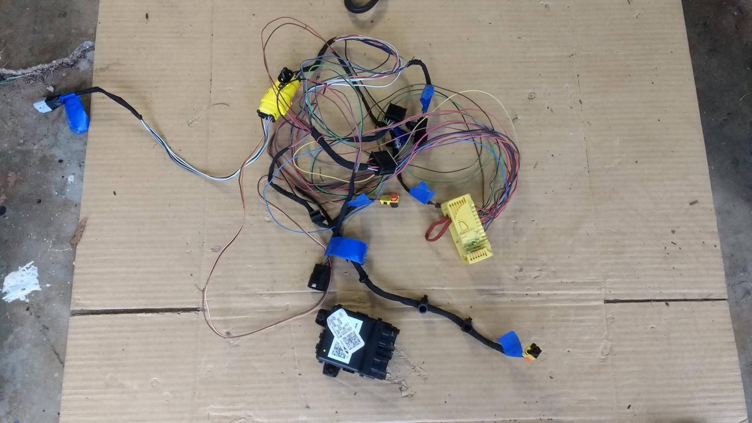

Yes, the pic I attached is the body side harness of my truck. I guess because my DS seat had power, the PS was wired for it? That really sucks. You're going to have to get + from somewhere and add a ground. I added the + and - from the new seat motor wiring harness to my seat side harness (I had to drill out the yellow seat connector holes in those slots and push the wires in). In terms of the SRS stuff. Look at your old seats and new seats. I'm going to bet your old seats are like mine where there is a small seat position sensor located on the seat rail towards the front. On the power heated seats it's part of the black box that powers/controls the heaters. You either need to swap all of your SRS wiring and sensors over to the new seats (putting the sensors on the brackets in the SAME spot as they were on your old seats) or get a new BCM and Wiring because I don't believe the SRS wiring matches up (again because the SRS stuff is integrated into the heated seat box). Without doing either of those things I don't think you'll ever get them to work. From what I've read, when the SRS light is on, NONE of the airbags will deploy. Also, to be clear, when I used my old seat harness, I was also retaining my yellow seat plug so the wire connections matched up to my body side plug, I just drilled and added the + and - as I noted above. You can get to the seat bottom stuff pretty easy, but unfortunately you will have to remove the upper seat cushion to get to the wires in the seat back. It's not terrible, everything un-snaps/unclips.
Oh wow. You might not have any power hook ups? I think you have a typo, did you mean to say the airbag light is on? Do regular cabs have side curtain airbags? See my pic below, if you have the spades to #11 and 12 you *should* at least have power to the seats. Look at your seat plug and see if these are there if you pull the plug back a bit, they're obvious, one is a fat red wire and the other is a fat black wire. These provide power for the seat controls (base, seatback, and lumbar): I just don't know. Reading other's posts in this thread you might need the BCM and wiring from the denali??? I was able to get mine to work by deleting the heater seat stuff, reusing all my OEM SRS sensors, wires, and equipment from my old seat onto my new and plugging the power wires into ports #11 and #12 on my "old" seat harness connector. Looks like GM went from making everything plug and play to actually having different harnesses and BCM's!
Turns out my airbag light was a little more serious than I had thought. Apparently GM didn't keep things simple, as has been discussed in this thread. The 2016 seat frame I bought had a power base, seatback, lumbar, AND heated seats (I only got the frame, so no cushions or heated seats, but the plugs and control module were there.) So I plugged it in, all the power stuff worked, cool, right? But my SRS light was on. Crap. Maybe it just tripped the code and needed to be cleared? I finally had time to really put the two seat frames side by side and compare. On my manual seat, the SRS system (airbag, seatbelt, weight sensor, and seat position sensor) were all obviously a stand a lone system with the seat position sensor being located on the inner seat track at the front. I couldn't quite figure out what was going on with my power seat, so I labeled all the clips and unwrapped ALL the wires. What I discovered: The power seat system is a stand alone system. It's its own harness (power base, seatback, and lumbar) and all the power stuff needs is a big + power wire to #12 on the seat connecter and a fat - wire to #11 on the seat connector. That's it. And luckily, the body side of my seat connecter was set up for this, more on that in a sec. There are NO other wires associated with the power seat or lumbar motors that go to the seat harness connector other than the fat + and fat - wires. That's it. On seats with heaters, (and possibly cooled, not sure as this wasn't a cooled seat), the SRS system is INTEGRATED with the seat heater system. The biggest thing being the seat positon sensor was part of the heater control box. That's why my SRS light was on, that and the wiring didn't match up to my seat's body side wiring. So apparently, this is the issues others have been talking about with heated seats having a different seat connector and body control module, etc. So, what did I do? I swapped my entire SRS system over to the new power seat frame. The entire wiring harness for the airbag, seatbelts, position sensor (the correct bracket in the correct location was even on the new seat, just unused, VERY important for the sensor to go to the same location) and I swapped the weight sensor system too, even though they did appear to be exactly the same. So now all my SRS stuff worked again, all warning lights off and gone, but now the power seat had no power. No biggie. The body side harness did have power and ground to terminals 11 and 12, I just had to drill them out in the seat connector and push them in. So now I have a power seat that works and an SRS system that works in a truck that originally only had a PS manual seat. This is a pic of the integrated SRS system/heated seat system. The black box you see controls the seat heaters and is also the seat position sensor for the SRS system, which is why it wouldn't work in my truck, because my truck doesn't have a BCM that works with this stuff, I can't use it, so NONE of this is going back into my truck. It now works properly with the old harness and a + and - power wire!

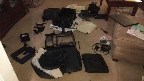

Thanks! This will be my 3rd seat covering, but first katzkin. I did a couple of the headrests already, vey nice stuff. I got the covers off! I got one side clip off, then the bottoms and it comes off. Whew! -
Bucket Seat Plastic Seat Back Removal Help!
67ChevyRedneck replied to 67ChevyRedneck's topic in Modifications & Accessories
That's the video I was referring too... looking at it again, I was pushing on the alignment tabs next to the clips last night... that's why it wasn't releasing... Thanks, I hope I can get them removed now... I wish they would have slowed down the video and explained stuff a little better. There's a GREAT step by step video for the 07-13's, but not for the 14+ O_J_Simpson (lol) - I hope not man, I already pegged my silver PS dash bezel with the seat track, I don't want to replace anymore parts... I have to find one of those now too, found plenty of DS ones. -
I have been scouring the web for videos, pics, anything that shows how to remove the plastic seat-back off of a 2014+ bucket seat and I can't find jack squat. Not even a pic of the cover. I just need to see how the clips work. I found one video online but it flys past that part with music playing... I know quite a few of our DIY'ers here have done a Katzkin interior and this is holding me up from tearing my seats down, as I do not want to break them, they need to go back on! Thanks for the help

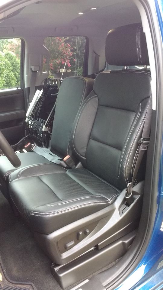

I received my power seat frame on Saturday and pulled the PS seat last night and set the frame in and plugged it in. All power motors worked including the lumbar. Very happy. I haven't taken the PS seat apart yet, so I don't have the airbag connected and I got an email from OnStar to bring my truck in for service immediately! My power seat frame is front/back, seatback, and lumbar. Current seat in my 2LT was all manual.
I may be in luck. The seller is including the attaching harness and it appears that there is a large red power and a large red negative wire going into the harness on either end. I popped the cover on my seat and unlatched the harness, and sure enough, on the body side in the spaces where those wires appear to be I have a large and medium sized spade, but when I look at the seat side of the harness, my seat has blank spaces (no pins) where the large and medium sized spades are, so hopefully, those are the power and ground wires and it will be plug and play. Fingers crossed, I'll find out next week.
So, I've done a lot of reading, and some googling, and haven't found an answer quite yet. I have a 2015 DC 2LT Z71 with cloth seats. I just ordered a katzkin interior kit (I've done a few interiors before, should be cake for me), but I have a question on seat power. My DS has full power controls (no heat or air). The PS is full manual and my wife has made a few comments on the lack of lumbar support (I mean really, on a 2LT??? My 00 Z71 LS had PS lumbar). So I ordered a stripped down frame from a 2016 with power seat motors and lumbar support (its the full frame with no cushions/cover). I can swap everything over when I do the leather covers. Does anyone know if this will be plug and play for power, or do I simply need to supply power/ground for the motors to work. This thread is packed full of confusing info on heaters, a/c, and BCM stuff. Seat frame and leathers should be here by next week. I paid the 2015 off a couple months ago and its upgrade time!
