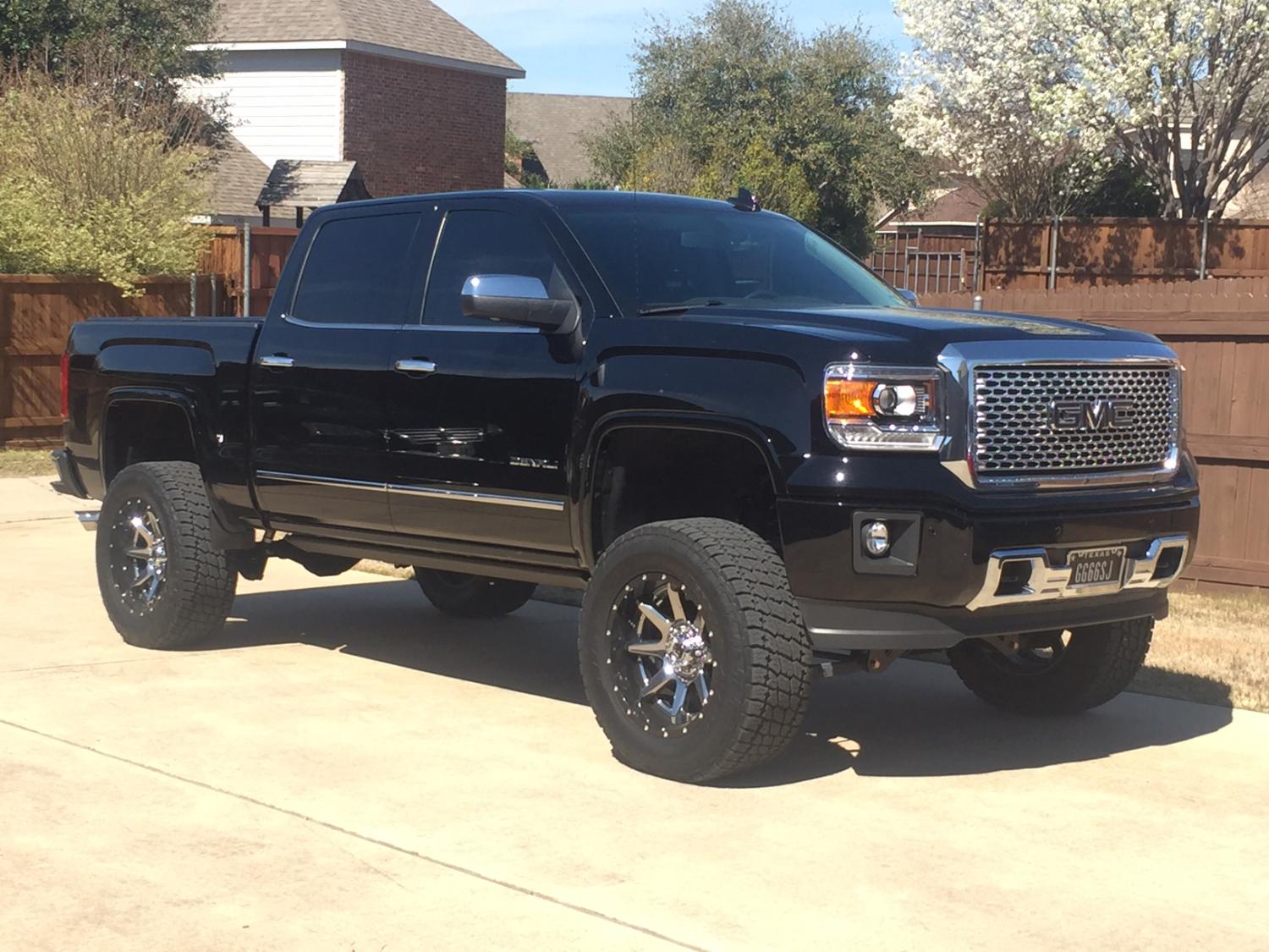

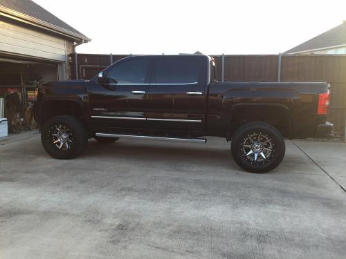

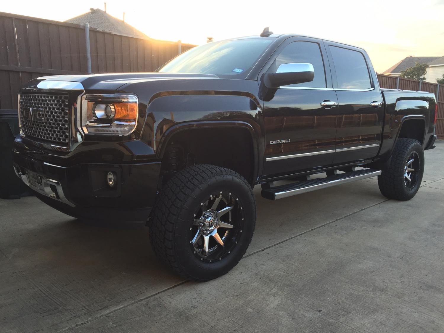

  8. Fabtech 6" lift kit, Nitto Terra Grappler G2 35x12.5 tires and Fuel Rampage 20x10 wheels

  10. 6" Fabtech lift with Fuel 20x10's on 35x12.5 Nitto Terra Grappler G2's

  12. I went through this about a month ago and was initially thinking the Fabtech 4" lift but found out the wheels I really wanted were too big, so went to a 6" kit. For the 4" kit you are going to need 33" tires and wheels - if you are thinking 20's - need to be 20x9....the Fuels I chose were 20x10 with a -19 offset and trying to squeeze them in with a 4" kit would have either required a lot of trimming or just wouldn't fit at all. The Fabtech kit will relocate the Magneride sensors. The ride afterwards wasn't bad but the shop that did mine is going to tweak them a little more next week as there is still a little bit more bounce in the ride thsn I like, almost like the Magneride system thinks it's compressed some. Hope this helps.
