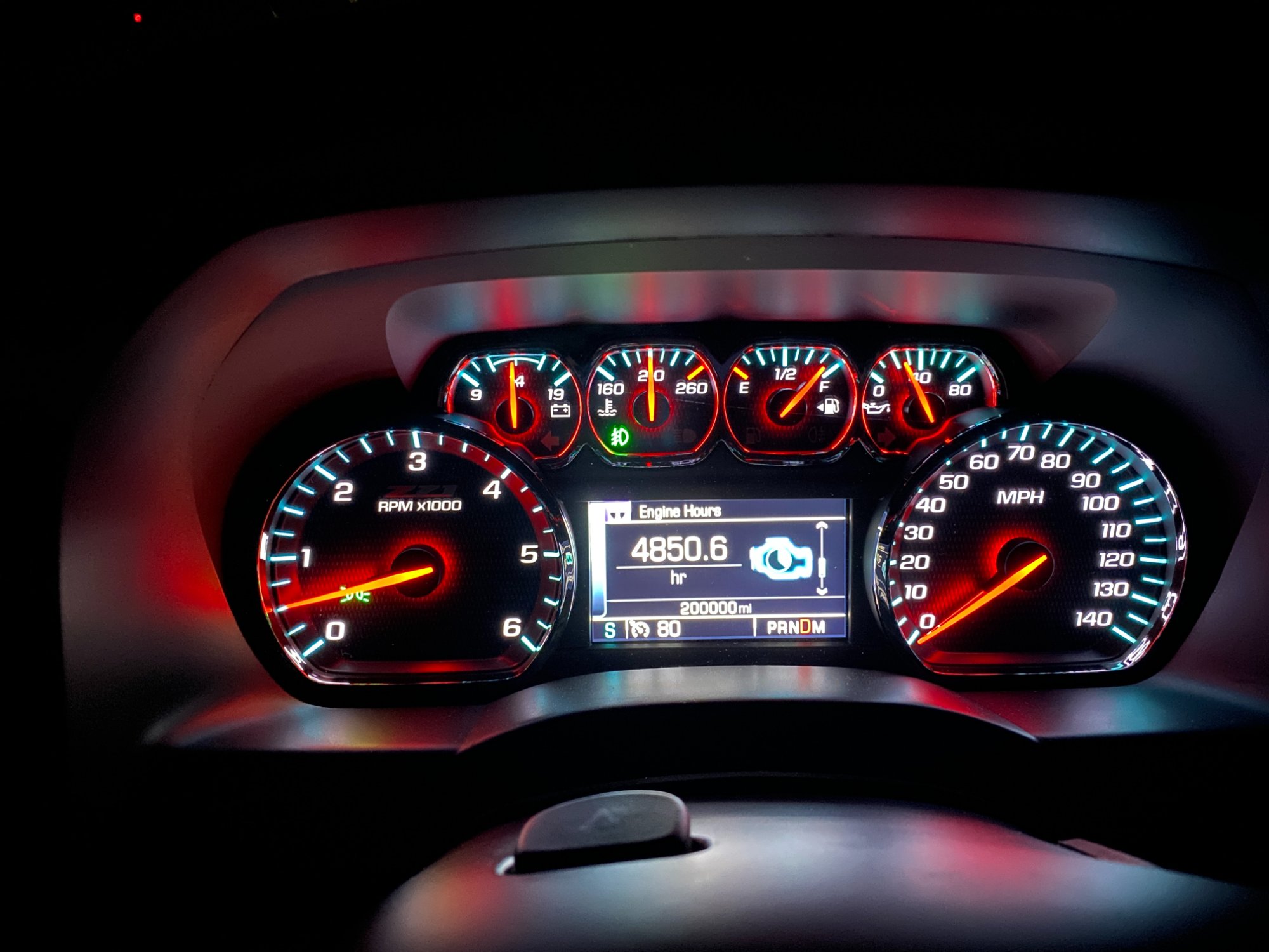

In the spirit of my 100k update, I figured I'd add one for 200k My experience with the K2XX platform over the past couple years. Drivetrain: No axle seal leaks or bearing concerns. Radiator was replaced at 140k due to a weeping leak caused by an exuberant thermostat that opened too quickly. No issues since then. 4WD system operates very well and has no issues. Due to cost effectiveness, the rear differential fluid was changed to AMSOIL 75W90 at 193k. Fuel mileage improved noticeably (1 mpg/tank), and the gains seem to have held, so I will continue with it. The easy pack is so nice for fluid changes too. Transmission: The 8 Speed (M5U) gave me some trouble for the balance of this period. Nothing affecting operability of the vehicle, but the problems found were obnoxious. The issues started at 116k, in June of 19, when I towed a 96 Cadillac Sedan DeVille Concours from Newbury Park CA to Casper WY. Speed limit followed for most of the trip was 55 mph, with a boost to 65 mph from Rawlins WY to Casper WY. The symptoms that developed included a harsh 1-2 shift at all times, with deteriorating shift performance as time wore on. The 1-2 shift was the primary concern, with other shifts being relatively well behaved. Initially I attempted to remedy the situation with a drain and refill at 148k. No dice. A relearn was performed at 158k with no benefit. A drain and refill occurred again at 162k, again with no improvement in symptoms. A drain and fill occurred again at 173k, along with a new transmission temperature sensor harness (this includes the plugs for the solenoids). Shifting performance very briefly improved, but returned to baseline at 174k and deteriorated after another relearn at 175k. Shifting started to improve at 178k following the thermostat delete, where I reversed the internals of the trans cooler thermostat. However, the shifting would deteriorate at high temperatures (170 and up). At 180k the transmission wiring (trans temp sensor, speed sensor wiring, and jumper to the body harness) were all replaced, and another drain and fill were completed. Again, performance briefly improved, though a relearn shortly after the repair negated any progress on shift quality. After discussion with my parts guy Tim at the local Chevy dealer, we surmised the heat related nature of shift deterioration was electrically related, and the only part left to replace was the valve body, as the solenoids are integrated.
