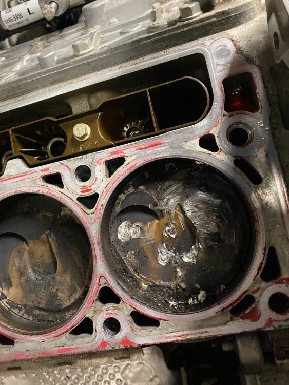

Jun 13th, 2024 brought 300k miles. Clyde is still trucking, though there have been some developments. Currently north of 326,000. Drivetrain: at 252,064 miles in August of 22 I developed a substantial misfire that significantly affected drivability. Made it home and attempted to diagnose the issue. New plugs and wires didn't solve the issue, and a new MAP sensor (was throwing a MAP sensor code and Cylinder 2 misfire). Injectors did not solve the issue either. Compression testing on Cylinder 2 suggested a massive issue as there was none, so I limped to the dealer. A teardown found likely the intake valve failed and eventually took the exhaust valve with it. The cylinder head took a beating, as the valve seats were damaged severely in a couple spots, and the piston was cracked all the way through. Due to costs related at the least to a removal and replacement, I decided on an engine replacement. I found a brand new engine out of Michigan Motorz for truck applications at $8,000, and the dealer installed it for another $6,000. I had initially suspected the original engine was toast, but I didn't have to turn it in for a core so I stuck it in storage. After a brief inspection the cylinder 2 wall appears to have survived. Unscathed. Further inspection is naturally merited, but I believe I have a rebuildable block on my hands. The new engine runs like a top, burns no oil, runs at temp, and gets slightly better fuel economy. Break in was textbook as I followed a 55mph speed limit with a rev limit of 3,000, no racing starts, no lugging, and generally gentle driving for the first 500 miles. Oil analysis shows the engine wearing in well. Interestingly the oil analysis showed no signs of failure prior to the valve drop. A couple hours prior to the valve drop I completely drained the tank and coasted to a stop at a pull off on the side of the interstate. I did 2 cranks at 10 second intervals, so that may have have something to do with it. I've been much more vigilant about gambling with fuel economy, and ran out once since then with immediate shutdown and no restarts. I leave myself a buffer of about 10 miles to empty before I stop to refuel.
I pulled and scrapped the vacuum pump cause they revised the design. The oil in the vacuum pump was clean. No sign of metal whatsoever. You can see in previous pictures the head and piston carnage. Those are toast. I will have to get some pictures but the Cylinder 2 wall is smooth to touch, no gouges, and showing factory crosshatch. I cannot believe it. Block and everything else will be inspected but I anticipate a rebuild. I appreciate the dealer's abundance of caution, but everything is looking quite promising. When the new engine was installed the radiator and the oil cooler lines were replaced, so the abundance of caution was continued. Will proceed with caution but I am over the moon. My factory engine will ride again!
New engine has 16k miles and is doing well. Recent fuel economy is right around 20 a tank. Quite pleased. I was able to do a much more proper break, with a 55 mph speed limit and 3000 rpm redline, as well as an oil change immediately following completion. That is the one bright spot, I have been able to get a much more detailed break in completed. That's good question Karnut, I did not see this coming, though now that it has happened, and I may have a spare, I may make a spare. Rest of the truck is in exceptional condition for the age, and resale is not a concern. If this happens again, I may wash, rinse, and repeat. Sure, things wear out, but with proper care I can slow the aging to a crawl.
Definitely going to do a full teardown and inspection, that's half the fun. Yeah I'm not optimistic about cylinder 2...this may be a spare parts source more than anything. Engine first developed symptoms at 252,030 miles (persistent misfire, related code, MAP sensor code, and inability to run relatively smoothly at idle). Engine gave up the ghost at 252,062 miles (stalled and would not refire) and was removed at 252,064 miles (got tugged to the dealer).
2015 Silverado LTZ Z71 6.2L L86 V8. Last fall my cylinder 2 valves decided they have enough and did a little tap dance on the top of the piston. The most cost effective option was replace the engine. GM did not have a reman unit available, so I found a new GM engine at Michigan Motorz, a marine engine shop in some state that starts with an M. Seeing as there was no core charge for my new engine, my old one is under wraps in my storage unit. Seeing as spring is finally here, the weather is suitable for long periods of activity in an unlit storage unit with no power. At the best I have a rebuild project, at the worst (and most likely) I have a new coffee table base. The Cylinder 2 piston is cracked, the valves are clearly shot (not that they would be reused in a rebuild), and there's obviously concern for metal in the oil. In the spirit of not ruining a rebuild, what should I toss? I've heard the intake is contaminated, and others have suggested the cylinder 2 injector is a no go. I'm thinking the VLOM is toast, likely the even bank cylinder head, and the vacuum pump (though that's the old design and would get scrapped anyway). Suggestions? Thank you for your time.
I do have an update It was not the plugs. Nor the ignition wires. Nor the Ignition coils. Nor the injectors. After the Injectors didn't cure the issue I used my boroscope to inspect all 8 cylinders. Likely an omen, cylinder 2 showed an orange liquid in droplet form on the top of the cylinder wall. Rotating the engine didn't show any apparent damage to the piston, but the cylinder did not hold compression upon further testing. After limping to the dealership further inspection revealed the valves let go in cylinder 2. I would venture a guess that the intake valve went first. Will provide pictures. Beat the heck out of the piston, cracking it, carved up the head something fierce, and scored the cylinder wall. GM listed a remanufactured engine as the option but they were on an indefinitely unavailable timetable. By the grace of God I found a marine engine shop in Michigan with, of all things, a brand new 0 miles crate GM L86 6.2L V8. Got that shipped to me, the dealer installed it, and all was well. 16,000 miles later Clyde is still going strong. They did a great job on the install. They recently swapped my wheels and did an amazing job. The guy who works on my Silverado there is the Corvette dude so it seems my reputation preceded me hahaha. Out of morbid curiosity I asked if they thought repair was a viable option ( I already knew I was going to say yes) and they also said, based on the condition of the entire truck, definitely.

2015 Chevrolet Silverado LTZ Z71 L86 6.2L V8. 252,062 miles. Coming home last week the SES light tripped, and it was flashing. Engine was running rough. Pull over, I happened to have a code reader on hand. P0106 (MAP sensor) and P0302 (Cylinder 2 misfire). I was able to limp home. Ran rough between 1000 and 2000, clear 2000 and it would smooth out considerably. Stopping was a questionable decision as there was a high chance of stalling. Stopping, shutting off the truck, and attempting to restart would result in a hard or no start condition. Once home I pulled a P0106, P0302, and P015C (Bank 2 Rich to Lean - O2 Sensor delayed response). Hard starts that get increasingly difficult the longer the truck is running. I changed the MAP sensor with marginal improvement in performance. I suspected spark may be an issue, so I pulled the plugs. They were carbon coated, though throttle body cleaner and a wire brush made it disappear. I changed the plugs and wires. That helped more but did not resolve the underlying issue. Hoping the issue was still relatively simple, I replaced the Ignition Coils. That helped substantially more, to where I think the truck could be drivable, though there still is an issue present. The first time I restarted after coil replacement, idle was rough and I got the same trio of codes that I did before replacing parts. I cleared them, let the truck sit for a second, and then started again. Starting was somewhat easier (though still had to turn over for about 10 seconds before it caught) and idle was somewhat smoother though still uneven. This time I got a P0300 (random multiple misfire) as opposed to Cylinder 2. The P0106 and P015C persisted. I know I'm kinda breaking the first rule of diagnostics by throwing parts at it, but at a quarter million miles it can't hurt. Though I'm not particularly excited about this prospect, I think the fuel injectors are suspect. I am aware of others' issues with injectors and have seen threads on this forum and videos chronicling the replacement of said injectors. Should I replace my injectors? Thank you for your time.
