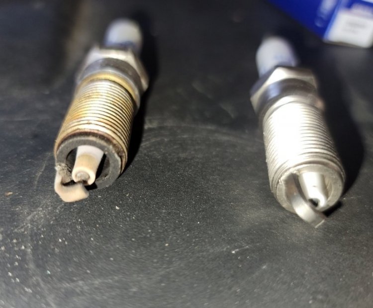

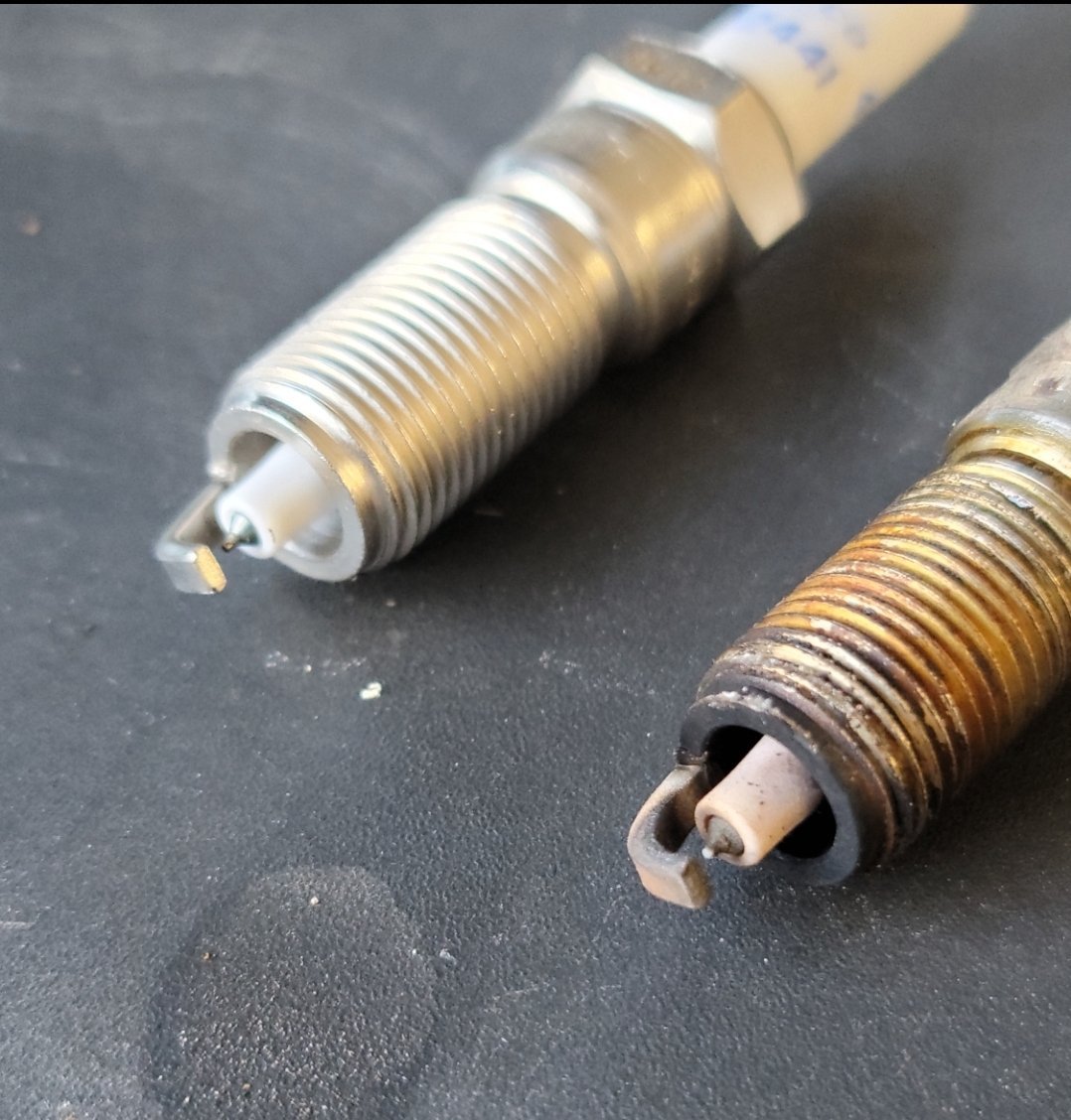

  10. All I can say is that cylinder #8 can SUCK IT!!! Wow, what a pain. Drivers side wasn't bad except the drive shaft in the way for #5 but still not bad. Passenger cylinders were a bit more challenging as less room available. Then comes cylinder #8... Can't even see the spark plug once the boot was off. I had to do it completely by feel and had to twist my body in ways that I don't think God meant me to. When looking at it I was very tempted to just say screw it and run with 7 new plugs and call it a day. But I knew it would keep eating at me so I dived in. Somehow I got it. I swear that it took almost as long to accomplish as all the other 7 combined. Well almost. Luckily I have a nice assortment of extensions including several wobbly ones too. I really have to remember that the next time I do this, I have to pick another day where it's not 96⁰. Overall, each plug looked about the same. Even #1 and #2. They definitely looked used but didn't look too bad. Here are screenshots of cylinder 1 plugs first which was the one that had the injector replaced and then #2 which kept showing me several misfires when cold and then smoothed out.

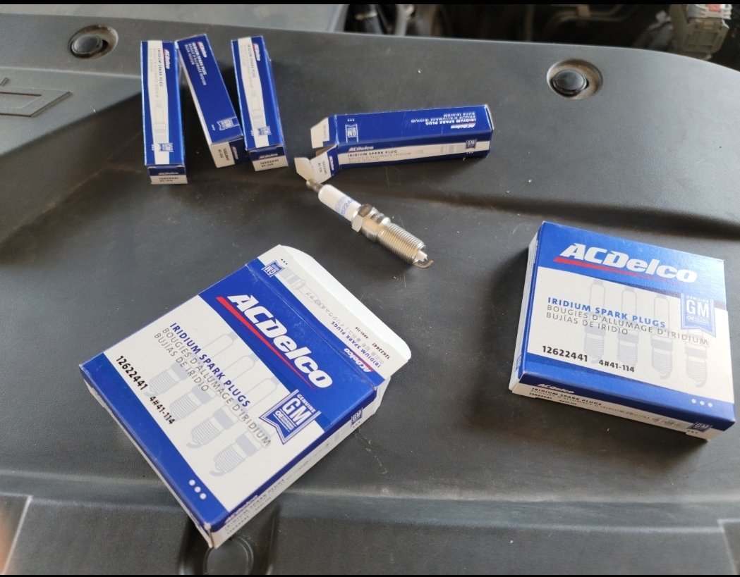

  11. Spark plugs now in hand. Just gotta wait for the motor to cool down a little bit more. I didn't get around to ordering the new wire set yet, I'm a terrible procrasinator... but at least now I will be pulling the old plugs to check them and get the new ones in. Oreilly is supposed to give me $24 in store gift cards once I submit the rebate and then I will also submit the rebate request to AC Delco for another $24 in rebates. I also had a $10 O'Reilly Rewards so after tax, each plug comes out to $3.22. Not bad.
  12. The OEM ACDelco plugs called for in my 5.3L Silverado that I am picking up tomorrow are 41-114 Iridium plugs.
