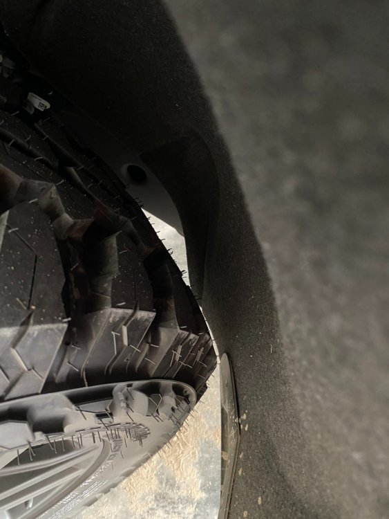

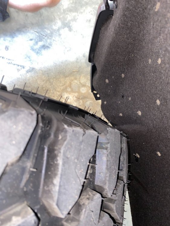

  2. Hey so on my 2021 AT4 with stock UCA and Stock 20" wheels I added 305/55 R20 Yokohoma MTs and I am very close to the UCA, but not touching it. If I added teh 2" RC leveling kit, does it move the UCA up or down or would I have the same amount of room? I hate to pay for the kit and have a shop install and then my tires don't fit. Thanks for any info.

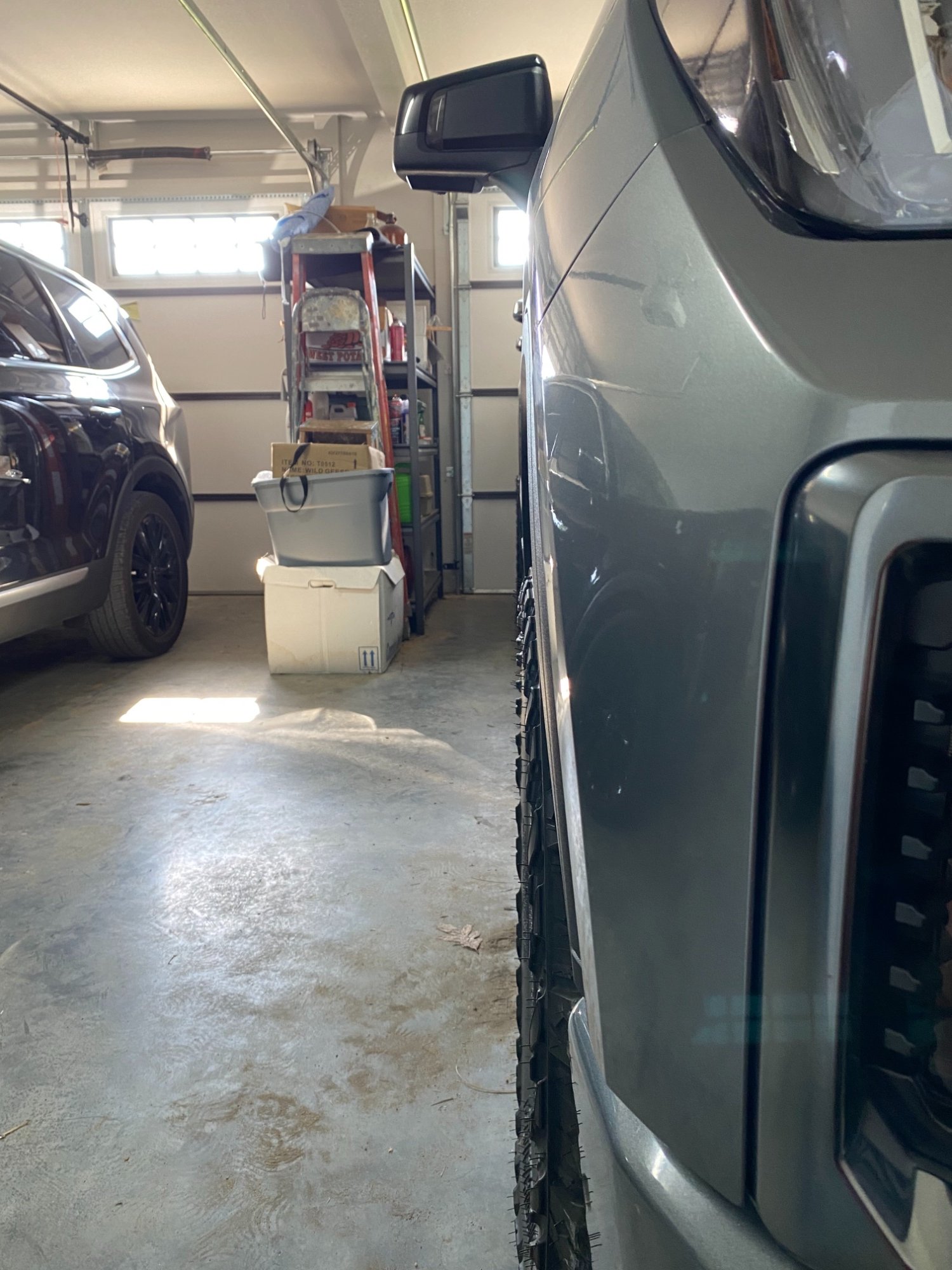

  15. If your talking to me everything is stock. I plan on adding a leveling kit. It’s close to running one of the bars in full lock, but not that close if it makes since. I’ll get some pictures later. Just had them put on Saturday.

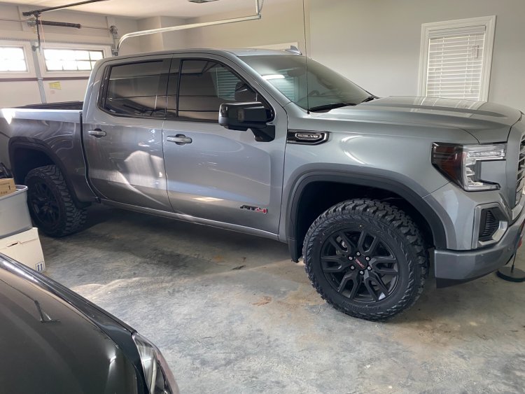

  16. I just put some Yokohama Geolander MTs 305/55 R20 on my 21 AT4 and they fit.

  22. Hey guys so I haven’t been on here much after I modded out my 15 Sierra. Here I am though. My transmission started giving me problems so I fixed it and got to good of a deal to trade it in. So I got my 2021 AT4 July the 8th and after looking on here you guys cost me a lot more money. I’ve tinted the windows, taillights, side part of headlights, fog lights and the blinker on the mirrors , plasti dipped the GMC logos and the AT part of the AT4, tail pipes, wheels, debadged sierra off back tailgate, bought the center storage kit off Amazon, put a flow master 40 serious on and cut off the flapper and tapped the resonators, ceramic coat, getting 305/55 R20 Yokohama Geolander MTs, I ordered Lund rock rails with rampage short steps (best looking nerf bars in my opinion). Wife’s not to happy on my spending lol. So once the heats off me I’ll buy and S & B cold air intake and an RC 2” level kit. I talked to RC today and they stated you do not need to change out the UCAs with their kit. Most others you do, but RC said they designed them this way.
