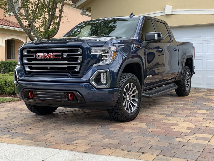

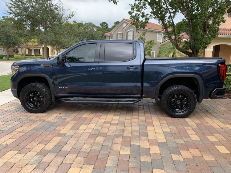

  1. 2019 AT4 6.2 on 20” BFG KO2s Black Rhino Kelso wheels 20x9 +12
  2. I chose 9” because I didn’t need any wider to fit 305s or if I decide to go up to 35x12.5 they’re still big enough. I was trying to find the balance between wider tires/wheels and not having the tires/wheels protruding from the side of the truck. Just want a cleaner look.
  3. 3mm just a bit under 1/8”
  4. Black Rhino Kelso 20x9 +12 offset 3mm hub centric spacers front only 305/55 BFG KO2 1.5” motofab level kit No rubbing at full lock
