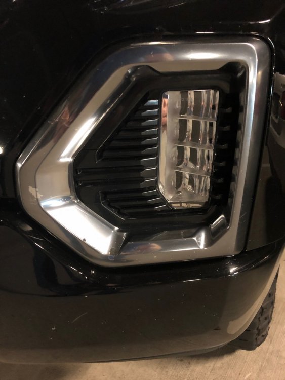

The coating which I believe gives the plastic chrome the black chrome look is coming off both my fog shrouds. FWIW, truck is a 2019 AT4. It's covered under warranty but I'm curious if this is a known issue or did I just get a "bad" set. I can't imagine I just lucked out and got two bad ones. Seems to me like if both of mine are peeling that I'm probably not the only one?

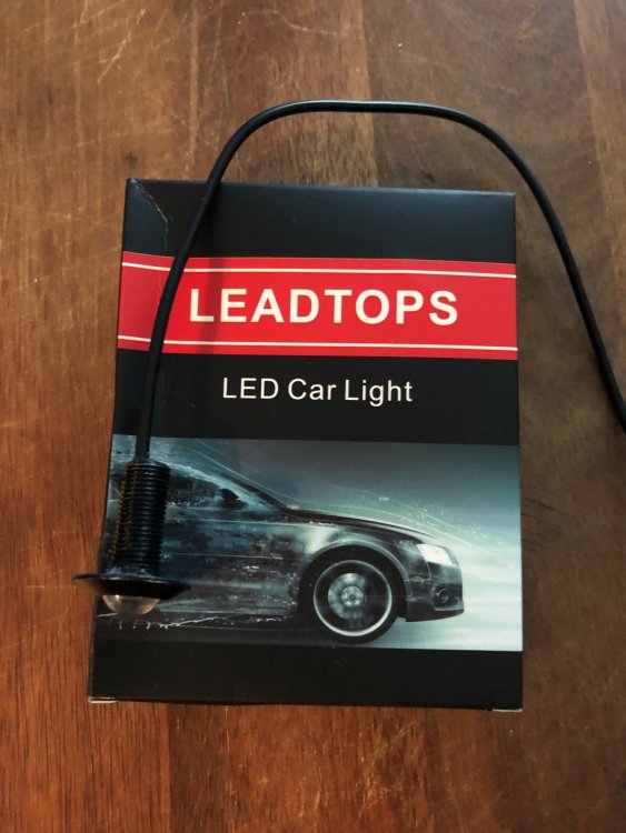

I grabbed power from fuse #40 which is Misc. Ignition. Anytime truck is running they're on. Link provided. Note these are rated at 90 lums and I wouldn't want them any brighter. Amazon has other similar lights by different manufacturers at the same price point but the next lowest lumen I saw was 120. https://www.amazon.com/gp/product/B01MU7IT47/ref=ppx_yo_dt_b_asin_title_o03_s00?ie=UTF8&psc=1 -

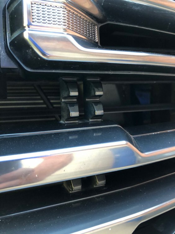

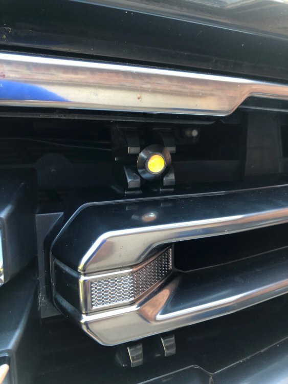

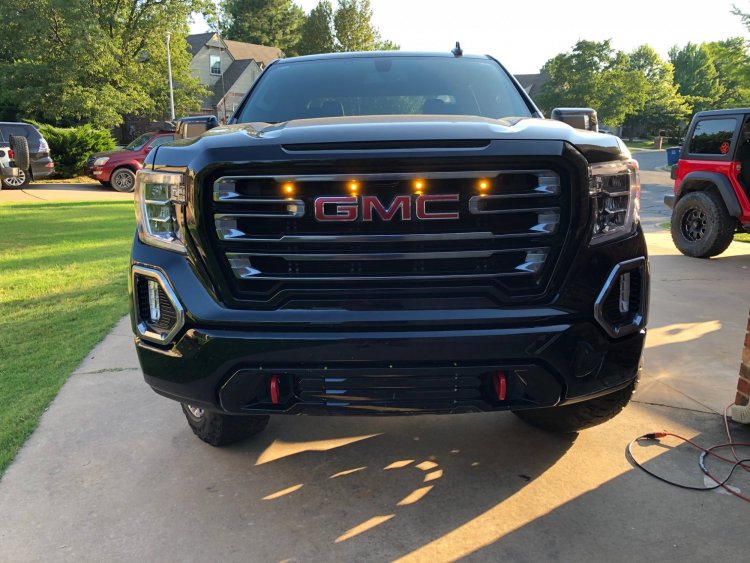

Installed some Amazon LED grill lights. I read a thread where guys were mounting on a 1" x 36" aluminum bar stock 1/8" wide. I did it a different way. I was playing around and found the threaded stud OD of the lights was just wide enough to "friction fit" them in the grill. I simply put the light in the "receiver" as shown and tapped them in tight with a socket against the outer flange of the light. They're in there pretty snug and I don't think I'll have any issues. I did super glue the flange to the body of the light as the flange pops off easily. Time will tell.... I think they look good without being over-the-top. Comments welcomed, I have thick skin.
Looks good
