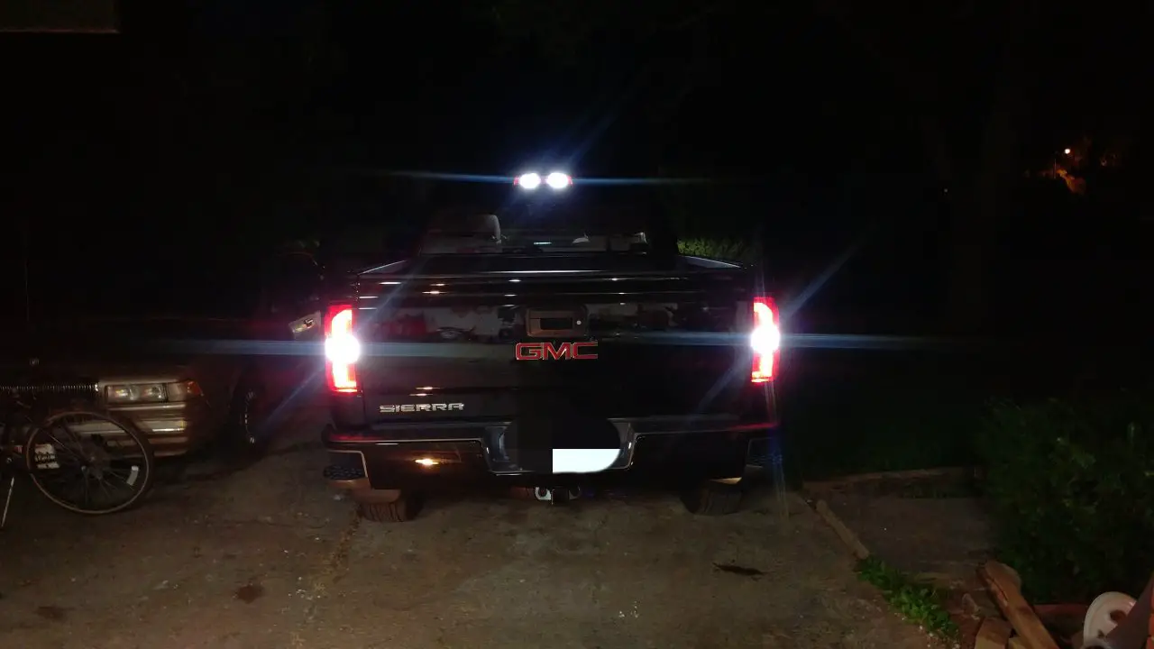

I just have to say thanks to the OP and the rest. Just did this on my 2017. Used a piece of single-strand 24ga hookup I had laying around. I got a nice set of LED backup and cargo replacement bulbs from eBay (link will be below), right after I picked the truck up because (esp in the rain) at night my backup camera was useless. They helped, some. I hit the seller up (had one of the plate lights go out) and asked about some brighter reverse lamps, and for an extra cost he shipped me a pair to try. Much better, and then when combined with the cargo lamp hack found here, it's almost as bright behind the truck in reverse as in front! https://rover.ebay.com/rover/0/0/0?mpre=https%3A%2F%2Fwww.ebay.com%2Fulk%2Fitm%2F182525013600 This link is for the original reverse lamps and cargo bulbs. I am asking the seller for an updated listing for the new reverse lamps and cargo bulbs. Will update when/if provided. Here is a pic of the original upgrade reverse lamps to compare. -
