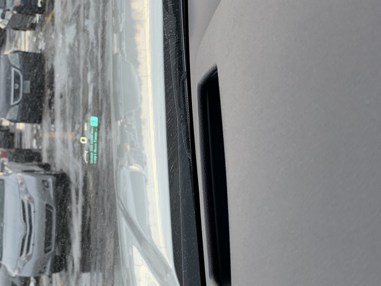

  2. that is the FCA (Forward Collision Alert) light module you can unplug it to remove the cluster __If you add the HUD, it would replace this device entirely

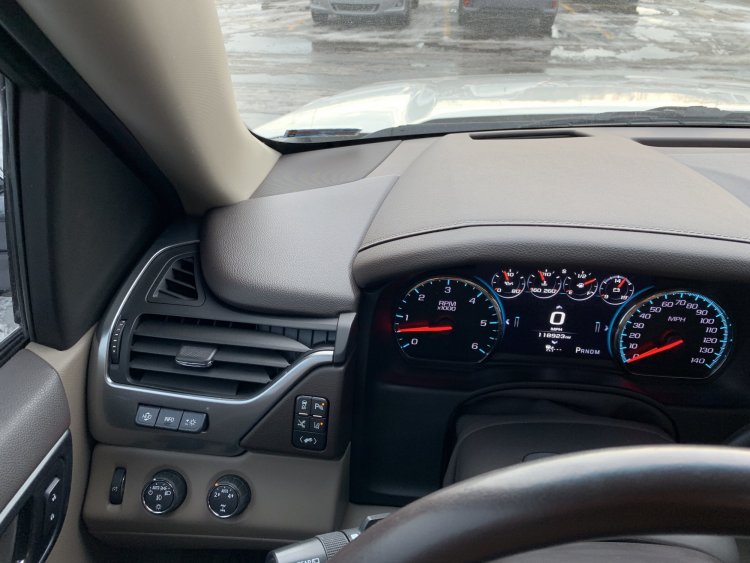

  5. I got my Instrument Cluster at Specmo it was $440 delivered Disclaimer...[since I am not a dealer and the cluster was not an exact replacement, the warranty was not valid - but I didn't/don't care, it worked as expected] The instrument cluster upgrade is awesome, adding the HUD made it more better

  12. I have a 2015 Suburban LTZ and I replaced it with a blue cluster 84254166 "2016 GAS US SPEC - DENALI STYLE LARGE DISPLAY BLUE/GREEN LIGHTING FOR CHEVY (SILVERADO/TAHOE/SUBURBAN ETC)"
  13. Another VERY Satisfied customer! With the help from this forum/thread I am now the proud owner of a GM. Chevy Suburban LTZ/D The final part was received today, and 2 hrs later - I have HUD with a Denali Cluster installed and operational Special Thanks to: Chris [GTPprix] for all you have done to help guid us to the correct Clusters for our applications as well as the programming magic you do so well Thanks cmatt for sharing your adventure and advice - thanks to you I was able to find and order the correct parts the first time (color/finish) Thanks to pgamboa for the well made wire harness at less than 1/2 the cost of the dealership price
