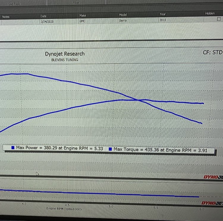

  12. So the guy that tuned my 6.2, just tuned a bone stock 6.2 on 93 octane, and my truck has just a cold air intake, heavier Ridge Grapplers, and the E85 conversion, and the bone stock after tuning the stock truck made 358rwhp/405 rwtq, mine made 380 rwhp/435 rwtq (on 65% ethanol per the sensor). So a gain of 22rwhp/30rwtq. The extra 30ft/lb of torque is noticeable. Since the tune I have been running E85 exclusively, except for a road trip I went on a couple weeks ago, I ran 93. The lesser torque was noticeable on the 93.
  13. My tuner said the same, that he doesn’t really mess with Torque Management on these trucks much either.
  14. True, I’m sure dialing back the torque management in the tune helped quite a bit, but the (estimated) extra 35rwhp/45rwtq from the E85 part of it didn’t hurt lol.
  15. It was not tuned prior to the E85, but with just a base E85 map loaded, the base pull was only down 10rwhp, 12rwtq vs the final pull. Adjusting AFR and timing further on subsequent pulls didn’t gain anymore than the final numbers. Plus, even the stock 5.3 is factory rated what 30-35 hp/tq more on E85, with .5 less compression, 0.9L smaller displacement, smaller cam. So the gains for the 6.2 converting to E85 are not really surprising.
  16. So now after driving it around a few days the torque difference alone is worth it to convert in my opinion.

  19. Just got my 2015 6.2 Sierra dyno tuned after adding the ethanol sensor, also did 8-speed tuning. Only mods are Volant intake, home ported throttle body, and E85 conversion with dyno tune, also on heavy Nitto Ridge Grapplers. 380rwhp/435rwtq. Pretty happy with the numbers.
