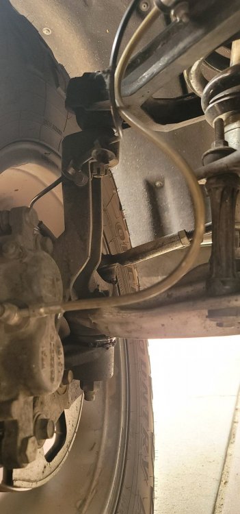

I can attest to rear air bags to rear, but depending on size lift, u will need a taller block and a spacer for air bag Eventually down the road u might want to get work done on your rear differential when going 33". Some claim u don't need it...but I suggest it Also for the guy that has 2wd...here's what I did in front for example..it's just an option Sorry for being dirty..it's usually clean but it is a work truck

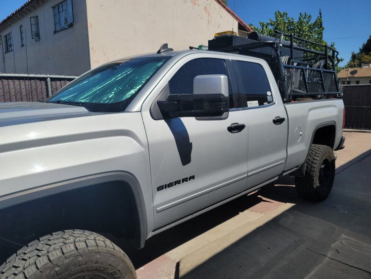

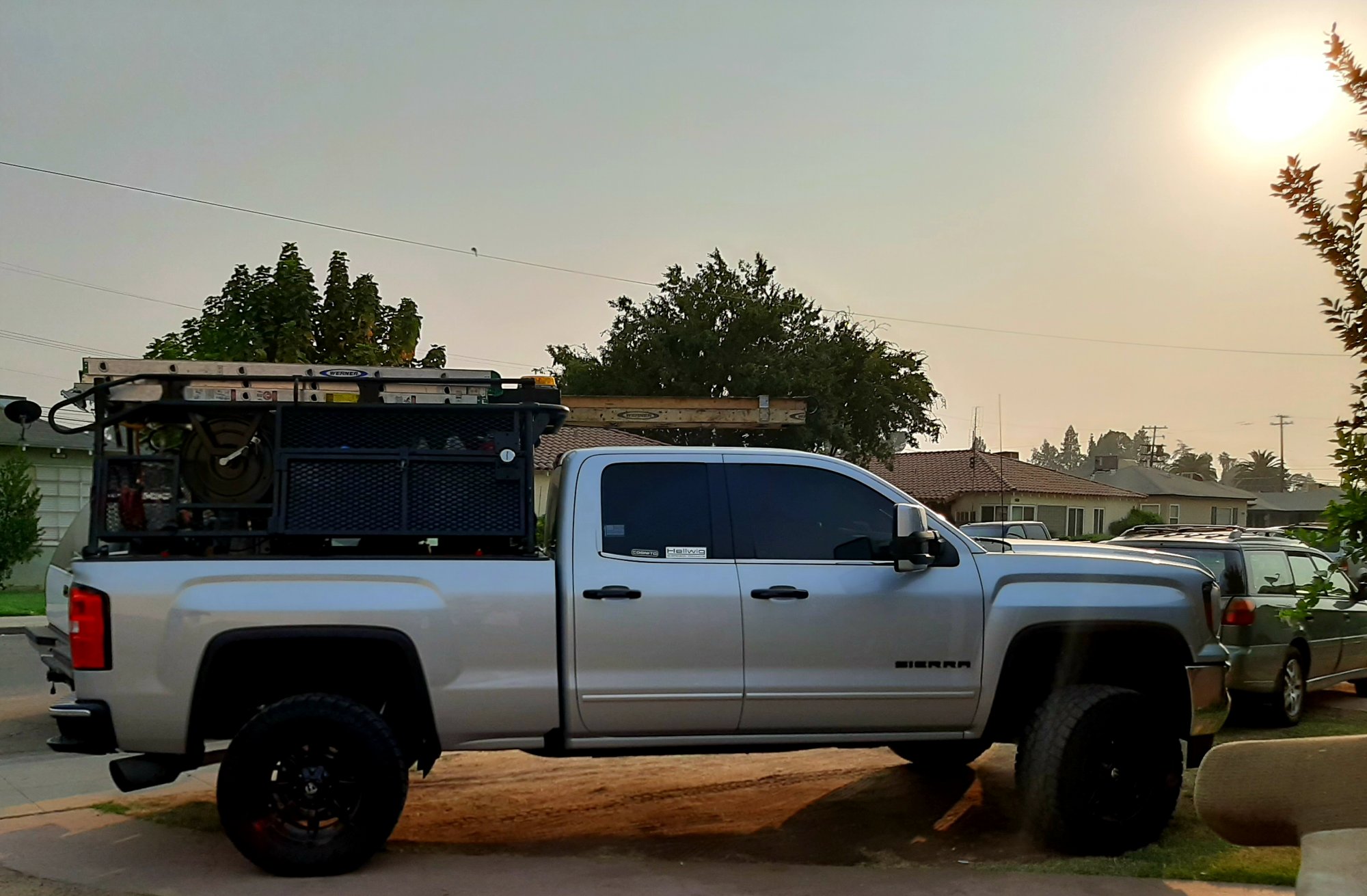

I think it's a matter of preference..for me personally, I started at leveling at 2 1/2", 5 now 6 1/2"..ya I know the weird height difference but my truck is unusual. Sorry for bad pic..it's quite hot out here

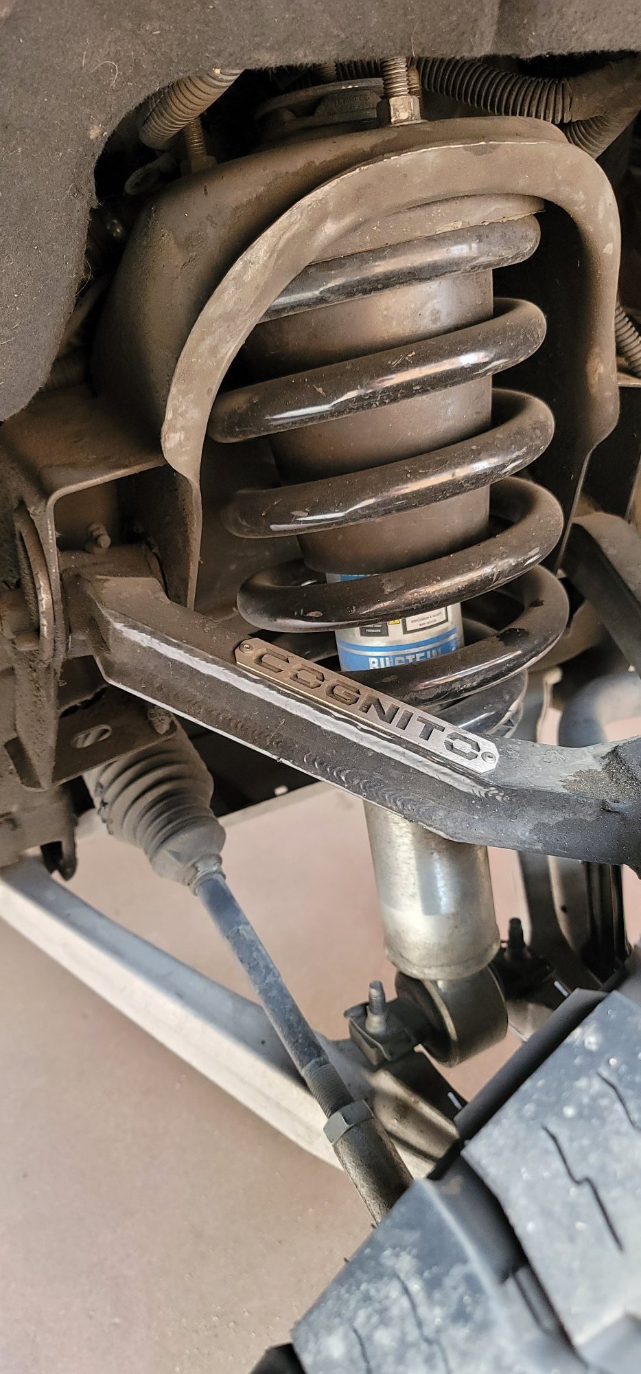

We should have more pics of lifted 2wd. I have a 2017 GMC Sierra, 2WD. It is currently at Fearless Gear here in Fresno getting rear differential changed to 4.56 and getting universal joint replaced. I could go 35's but I plan to stay at 33. I will post pics when truck gets back, hopefully Friday. I have appointment with Linex at 10 am. I lifted mine purely based off of looks, never offroad - tbh, I just got tired of the 2500's, etc, sitting taller than me on the road - thats it. In the front, I went with a MaxTrac 5" knuckle lift, Bilstein B8 6100 set at 0" (I didnt want to to go higher than 5), Cognito UPC (not needed but I did it anyway because of the better ball joint). I also had to replace lower control arm because replacing that lower ball joint was a pain and I ending up buying 2 LCA at O'Reilly's. As far as the back, I put 3" rear block..I also have Airlift air bags and I had to buy 4" spacer as well. Also have Hellwig rear sway stabilizer. The knuckle lift will space out your tires out some, so to some, it will look out of place in comparison to the rears. You can add spacers to rear but i chose not to. You can go mcGaughy's route..I live in Fresno so you will see alot of their trucks around here..I really wanted their front crossmember but that's about it. I will post pics most likely this Friday. Good luck

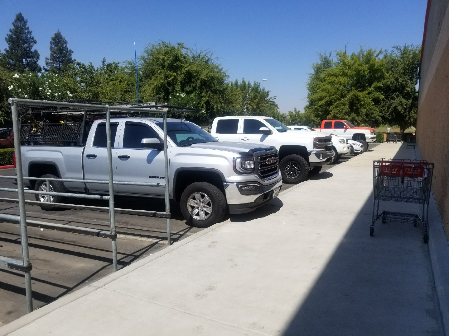

Hopefully this is where to post, it's just another pic of different truck heights. Took this earlier today @ Costco and I was happen to park near these trucks. Mine at 2" with Rancho quicklift and airbags in rear, the middle truck I'm assuming 5" and the end is taller yet. There is a Toyota Tacoma in there as well but meh.
