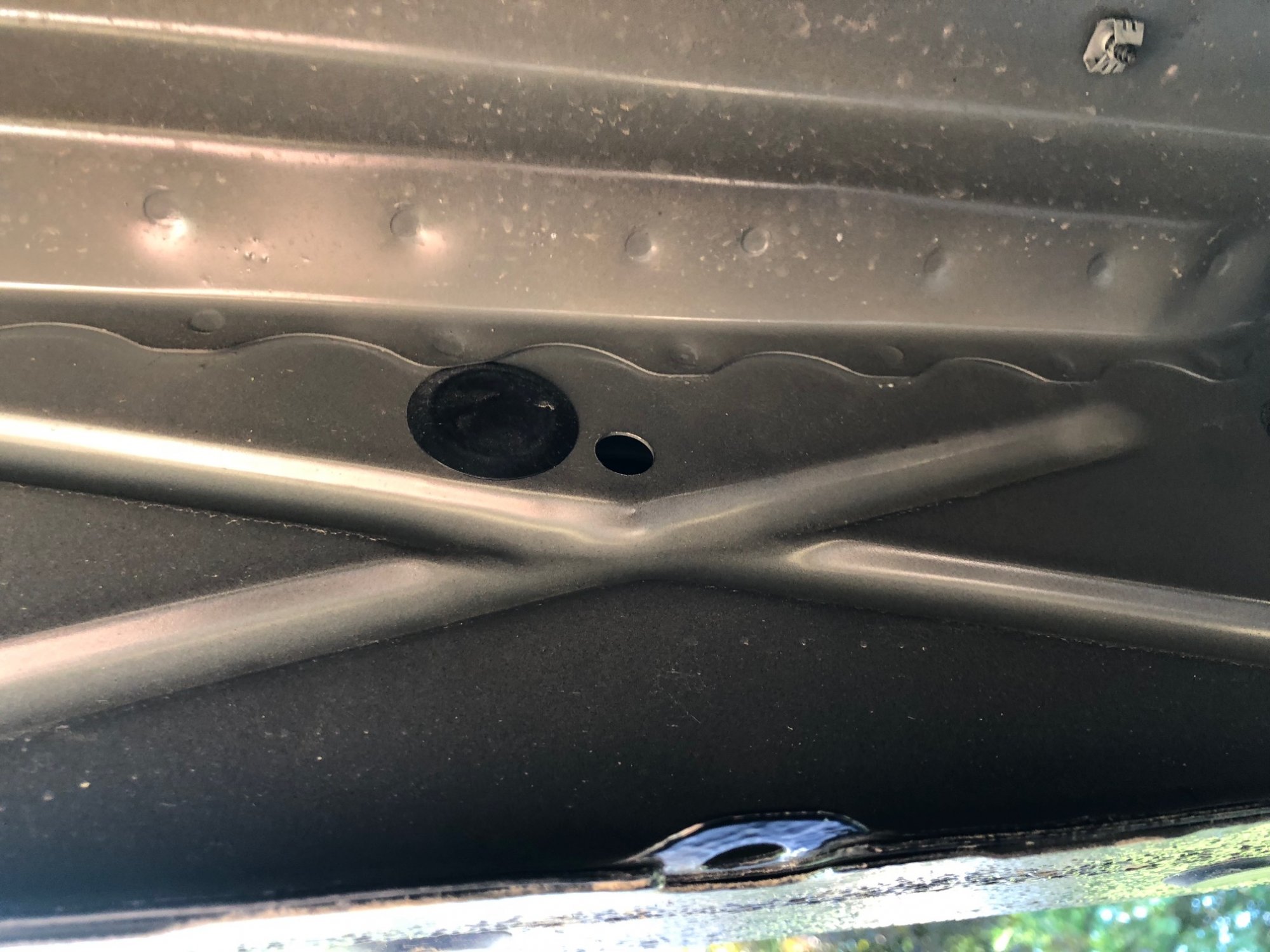

  7. Im trying to install my Westin 4" Nerf bars in my 1 1/2 month old 2018 Silverado. In the instructions it says there should be threaded holes in the body of my truck to install the brackets. The only place that shouldnt have threaded holes is the back passenger side. I even looked on youtube and everyone is showing the same. Attached picture is my front drivers side rocker right after the front wheel. As you can see there are no threaded holes to be found. Its the same as this all the way around the truck. Anyone run into the same issue, or what am I doing wrong?
